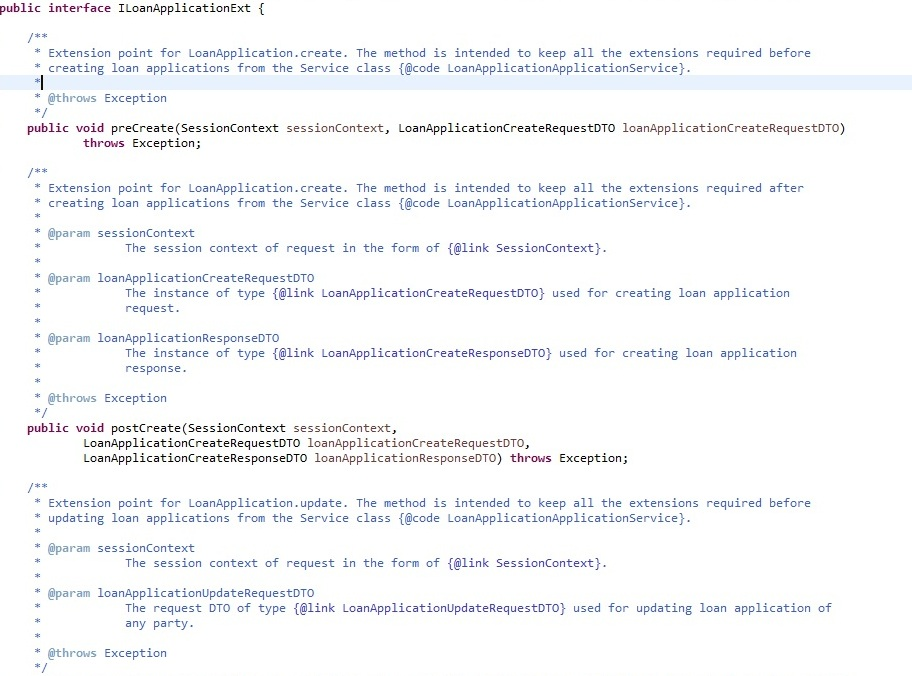

3.2.1 Service Extension Interface
This interface has a pair of pre and post method definitions for each application service method of the present. A service extension class has to implement this interface. The ‘pre’ method is the pre-extension hook as explained before. Similarly the ‘post’ method is the post-extension hook.
Multiple implementations can be defined for a particular service. The service extensions executor invokes all the implementations defined for the particular service both before and after the actual service executes. The signatures of these methods are:
public void pre<Method_Name>(SessionContext, <Method_Parameters>)
throws Exception;
public void post<Method_Name>(SessionContext, <Method_Parameters>,
ResponseDTO) throws Exception;
Naming Convention
The naming convention of service extension interface is
I<Service_Name>Ext
For example, consider below code sample.
