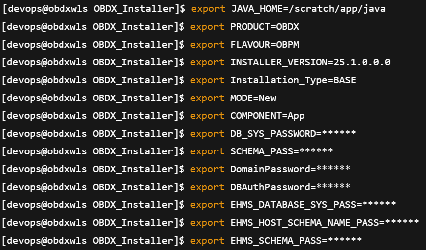

Below values to be exported before running installer in silent mode.
export PRODUCT=" "
export FLAVOUR=" "
export INSTALLER_VERSION=""
export Installation_Type=" "
export COMPONENT=""
export DB_SYS_PASSWORD=""
export SCHEMA_PASS=""
export DomainPassword=""
export DBAuthPassword=""
export EHMS_SCHEMA_PASS=""
export EHMS_HOST_SCHEMA_NAME_PASS=" "
export ENTITY_EHMS_DATABASE_HOSTNAME=" "
export ENTITY_EHMS_DATABASE_PORT=""
export ENTITY_EHMS_DATABASE_SID=" "
export ENTITY_EHMS_DATABASE_SYS_USER=" "
export ENTITY_EHMS_DATABASE_SYS_PASS=" "
export ENTITY_SCHEMA_NAME=””
export ENTITY_SCHEMA_PASS=" "
export ENTITY_EHMS_HOST_SCHEMA_NAME=" "
export ENTITY_EHMS_HOST_SCHEMA_NAME_PASS=" "

- Set the environment variables , as shown below
Below parameters should be set as environment variables, depending on the Host system the installer should be executed.

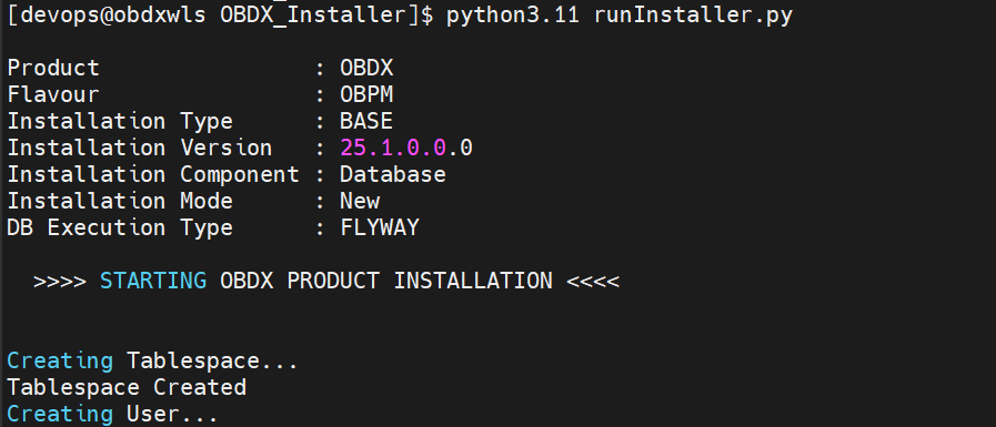

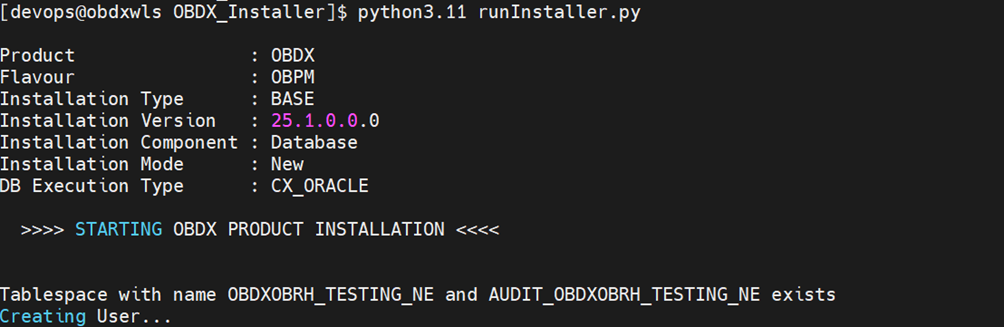

Run the runInstaller.py file with ‘--silent ’ argument along with ‘--base’ option.
Installation Status

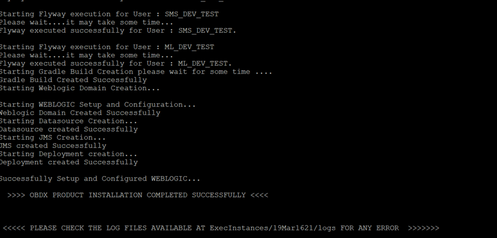

The status is displayed on the terminal to indicate the progress of the installation.
If DB_EXECUTION_TYPE set to FLYWAY
If DB_EXECUTION_TYPE set to CX_ORACLE
When the installation completes, the below message is displayed
