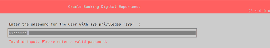

Invalid database password
This topic contains troubleshooting information if you receive an error when attempting to connect to the database server.
If you get the following error:
Try one of the following:
- Verify that the database is running.
- Check Network connectivity between Weblogic Server and Database server.
- Check the database configuration in installer.properties file
- Verify that the entered password is correct.

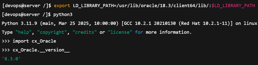

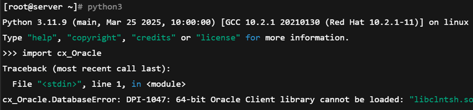

cx_oracle module
This topic contains troubleshooting information about problems with cx_Oracle python module.
Execute the below command:
export LD_LIBRARY_PATH=/usr/lib/oracle/19.10/client64/lib:$LD_LIBRARY_PATH
python
import cx_Orace
cx_Oracle.__version__

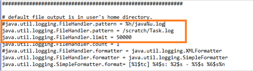

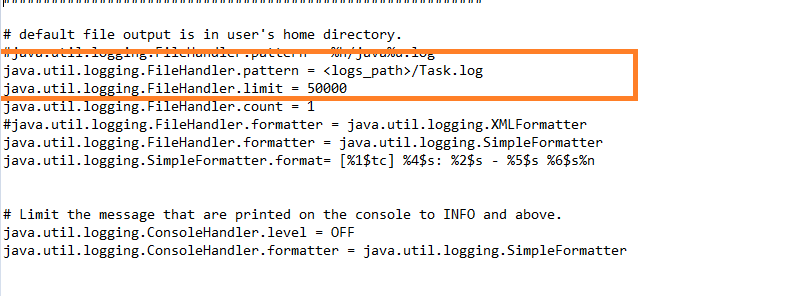

- Edit Entitlement_log4j.properties , Task_log4j.properties &
Dashboard_seed_log4j.properties . Replace <logs_path> with directory where
policy seeding logs will be generated
e.g.
