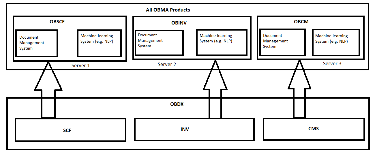

3 Complex Scenario
Here all OBMA products are installed on separate servers and every OBMA product has DMS and NLP system installed. In such a scenario, documents uploaded on DMS of OBCM will not be accessible by NLP of OBSCF.
For NLP of OBSCF, documents must be uploaded on DMS of OBSCF. And for NLP of OBINV, documents must be uploaded on DMS of OBINV and so on.
NLP & DMS of same OBMA products can interact with each other but not across OBMA products.Thus in OBDX:
- All content transactions and NLP transactions done for module SCF should interact with DMS and NLP system of OBSCF
- All content transactions and NLP transactions done for module INV should interact with DMS and NLP system of OBINV.
Hence, default configurations cannot be used in this scenario. To achieve this, a configurator table has been added:“DIGX_MO_CONFIGURATION_SELECTOR” . For modules, where module specific HOST IP, PORT & HEADERS are to be picked instead of default configurations, entries can be made in this table. Thus using this table, every module can interact with DMS and NLP systems of their respective mid-office products. For such modules, the configuration in this table has been overridden.
Previously, actual configuration values were stored in tables like: DIGX_FW_CONFIG_ADAPTER_PROP_B, DIGX_FW_CONFIG_VAR_B and configuration variables were created in AdapterConstants.java of Host implementation.
With the addition of the DIGX_MO_CONFIGURATION_SELECTOR table, configuration values will still be stored in same tables. The only difference would be that instead of providing configuration variables via AdapterConstants.java, they will be provided by the table.
TheDIGX_MO_CONFIGURATION_SELECTOR table contains the variable names of configurations which are to be overridden and not the actual configuration values.
