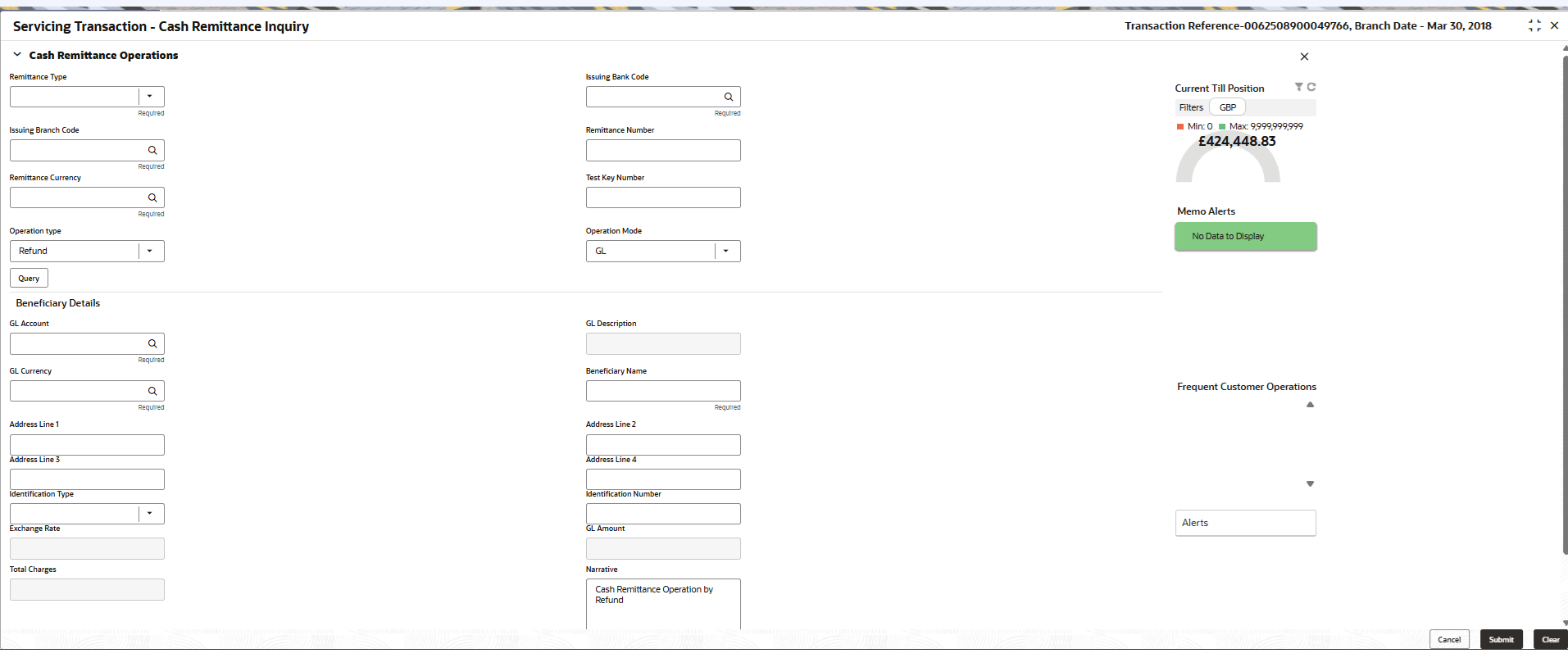

Figure 5-51 Cash Remittance Operations (Refund by GL)
- On the Cash Remittance Operations screen, specify the
fields. For more information on fields, refer to the field description
table.
The fields marked as Required are mandatory.Table 5-49 Cash Remittance Operations (Refund by GL) - Field Description

- Specify the charge details. For information on the fields in the Charge Details segment, refer to Charge Details.
- Click on the Remittance Details data segment to view the
additional details of the remittance.
This data segment is non-editable. - Click Submit.
A teller sequence number is generated, and the Transaction Completed Successfully information message is displayed.
The transaction is moved to authorization in case of any warning raised when the transaction saves.On transaction submission, the system will hand off the request to Oracle Banking Payments using Instrument Pay Service. If the remittance is issued by another bank, the Oracle Banking Branch has to provide the test key number during handoff for validation. On transaction completion, the Oracle Banking Branch will hand off accounting to FLEXCUBE Universal Banking for the main leg.
