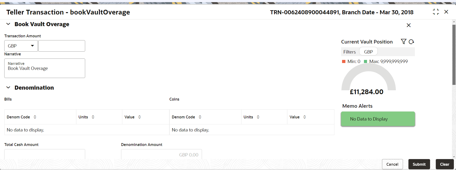

  1. On the Home screen, from Teller mega menu, under Till-Vault Operations, click Book Vault Overage or specify Book Vault Overage in the search bar and select the screen.
    The Book Vault Overage screen is displayed.
  2. On the Book Vault Overage screen, specify the fields. For more information on fields, refer to the field description table.
    Table 2-15 Book Vault Overage - Field Description
    Field Description
    Transaction Amount
    Displays the local currency of the branch.
    Specify the amount that needs to be booked for the overage.
    Note: The user can select another currency from the drop-down values in which the shortage amount is to be booked.
    Narrative
    Displays the default narrative Book Vault Overage and it can be modified.
  3. Specify the denomination details. For information on the fields in the Denomination Details segment, refer to Add Denomination Details.
  4. Click Submit.
    A teller sequence number is generated, and the Transaction Completed Successfully information message is displayed.
