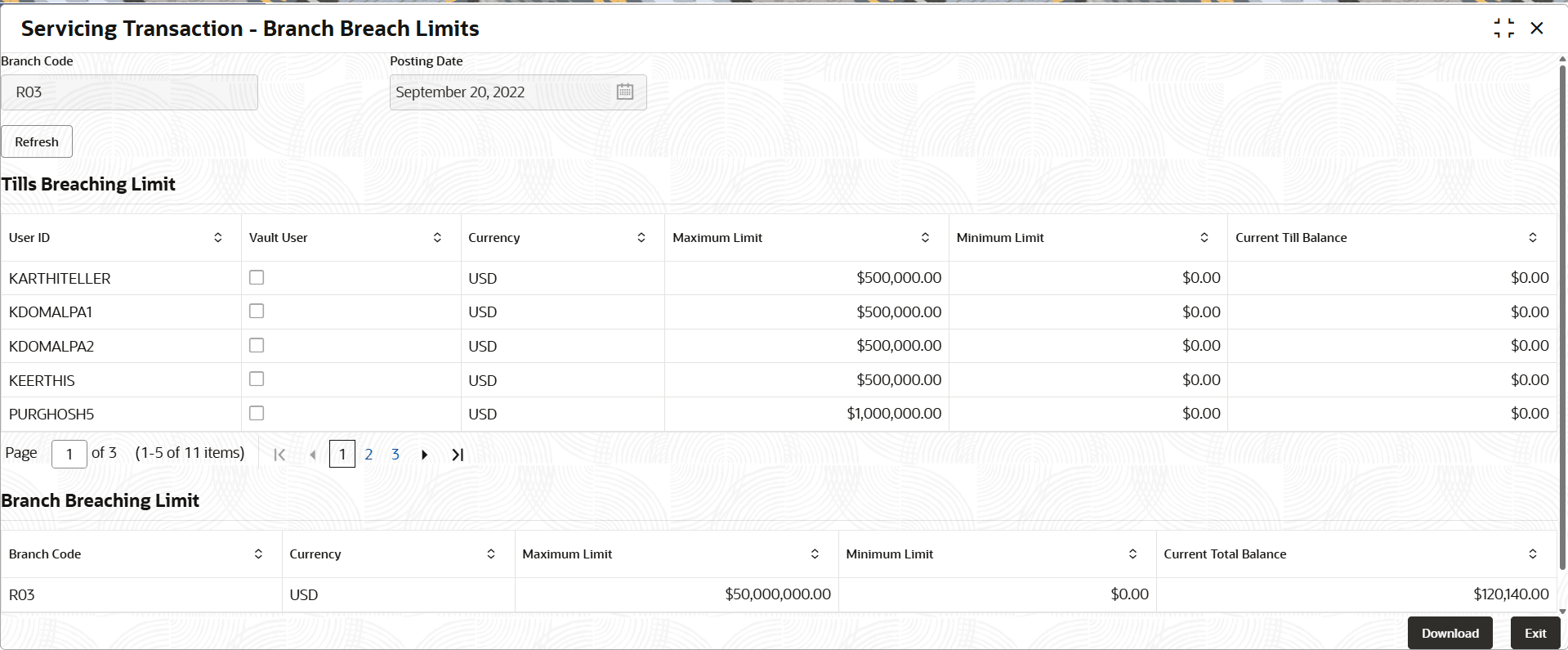

2.5 Branch Breach Limits
The Branch Breach Limits screen helps to view the details of Till or Vault, which is breaching the currency limits along with the current balance position.
In addition, the branch supervisor can view the branch's total cash position and its breaching limits for the posting date.
To view the branch breaching limits:
  1. On the Home screen, from Teller mega menu, under Branch Operations, click Branch Breach Limits or specify Branch Breach Limits in the search bar and select the screen.
    The Branch Breach Limits screen is displayed.
    Users can access the inquiry, without requiring an open teller batch.
  2. On the Branch Breach Limits screen, specify the fields. For more information on fields, refer to the field description table.
    Table 2-5 Branch Breach Limits - Field Description
    Field Description
    Branch Code
    Displays the logged-in branch.
    Posting Date
    Indicates the date on which the branch breaching limits needs to be inquired.
    Note: By default, the system displays the current date.
    Refresh
    Click this icon to refresh the details.
    Tills Breaching Limit
    Specify the fields under this section.
    User ID
    Displays the list of Tellers or Vault Tellers of the branch.
    Vault User
    Displays the checkbox if the User ID is a Vault Teller.
    Currency
    Displays the list of currencies in which the User ID has performed the transactions.
    Minimum Limit
    Displays the minimum till balance that needs to be maintained for the User ID and currency combination.
    Maximum Limit
    Displays the maximum till balance that needs to be maintained for the User ID and currency combination.
    Current Till Balance
    Displays the current till balance based on the till cash position for the specified currency.
    Branch Breaching Limit
    Displays the values under this section.
    Branch Code
    Displays the code of the logged-in branch.
    Currency
    Displays the currency code.
    Minimum Limit
    Displays the minimum limit that needs to be maintained for the branch.
    Maximum Limit
    Displays the maximum limit that needs to be maintained for the branch.
    Current Total Balance
    Displays the branch total cash position, currency-wise.
  3. Click Download button to download the Inquiry Result.
