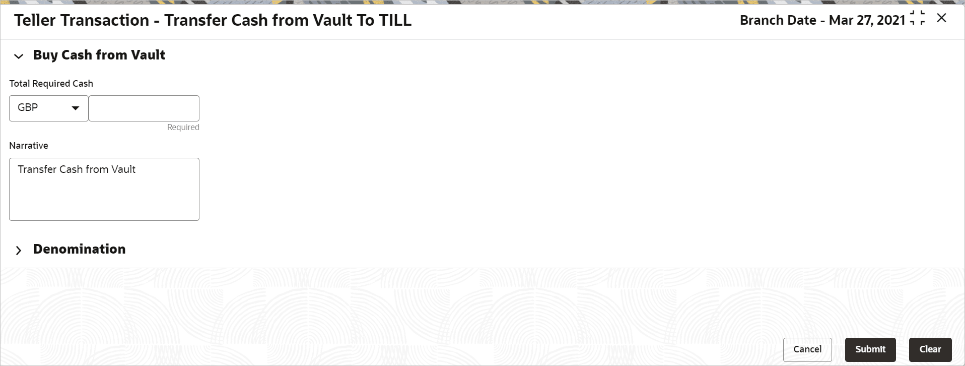

  1. On the Homescreen , from Teller mega menu, under Till-Vault Operations, click Buy Cash from Vault or specify Buy Cash from Vault in the search bar and select the screen.
    The Buy Cash from Vault screen is displayed.
    Figure 11-1 Buy Cash from Vault
  2. On the Buy Cash from Vault screen, specify the fields. For more information on fields, refer to the field description table.

    Note: By default, the system displays the local currency of the branch. The user can select another currency from the drop-down values in which cash needs to be transferred from the vault.
    Narrative Displays the default narrative as Transfer Cash from Vault, and it can be modified.
  3. Specify the denomination details. For information on the fields in the Denomination segment, refer to Add Denomination Details.
  4. Click Submit.
    A teller sequence number is generated, and the Transaction Completed Successfully information message is displayed.
