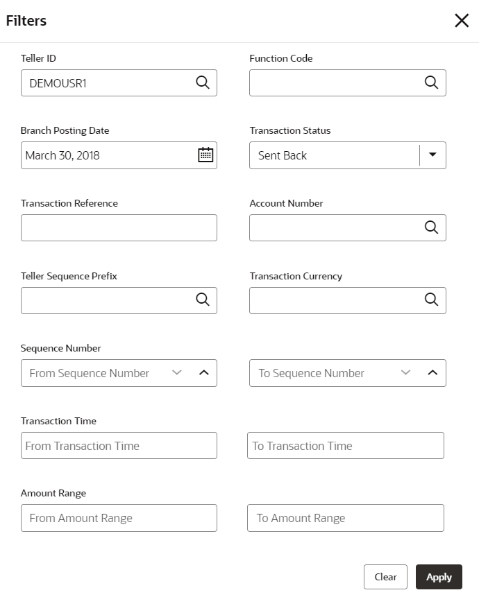

  3. Click Filter icon to filter the results on the tile or grid view based on the search criteria.
    The Filters overlays screen is displayed.
    Figure 6-2 Filters (Electronic Journal)
  4. On the Filters overlays screen, specify the details to fetch the records. For more information on fields, refer to the field description table.
    Table 6-6 Filters - Field Description
    Field Description
    Teller ID
    Specify the Teller ID.
    Note: User can also click the Search and select the Teller ID from the list of values.
    Function Code
    Specify the function code for which the inquiry is to be made.
    Note: User can also click the Search and select the function code from the list of values.
    Branch Posting Date
    Specify the branch posting date for which the inquiry is to be made.
    Note: By default, the current posting date is displayed.
    Transaction Status
    Select the transaction status from the drop-down values.
    Note: By default, Sent Back status is selected.
    Transaction Reference
    Specify the transaction reference number.
    Account Number
    Specify the account number.
    Note: User can also click the Search and select the account number from the list of maintained account numbers.
    Teller Sequence Prefix
    Click the Search and select from the list of values.
    Transaction Currency
    Click the Search and select the transaction currency from the list of values.
    From Sequence Number
    Specify the start number of the sequence range.
    To Sequence Number
    Specify the end number of the sequence range.
    From Transaction Time
    Specify the start time for filtering transactions executed within the given time range.
    To Transaction Time
    Specify the end time for filtering transactions executed within the given time range.
    From Amount Range
    Specify the from amount of the amount range.
    To Amount Range
    Specify the to amount of the amount range.
  5. Click Apply.

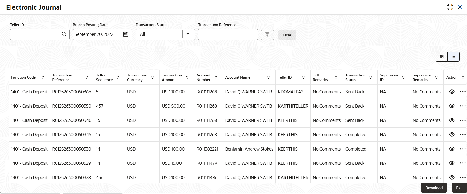

    The Electronic Journal screen displays.

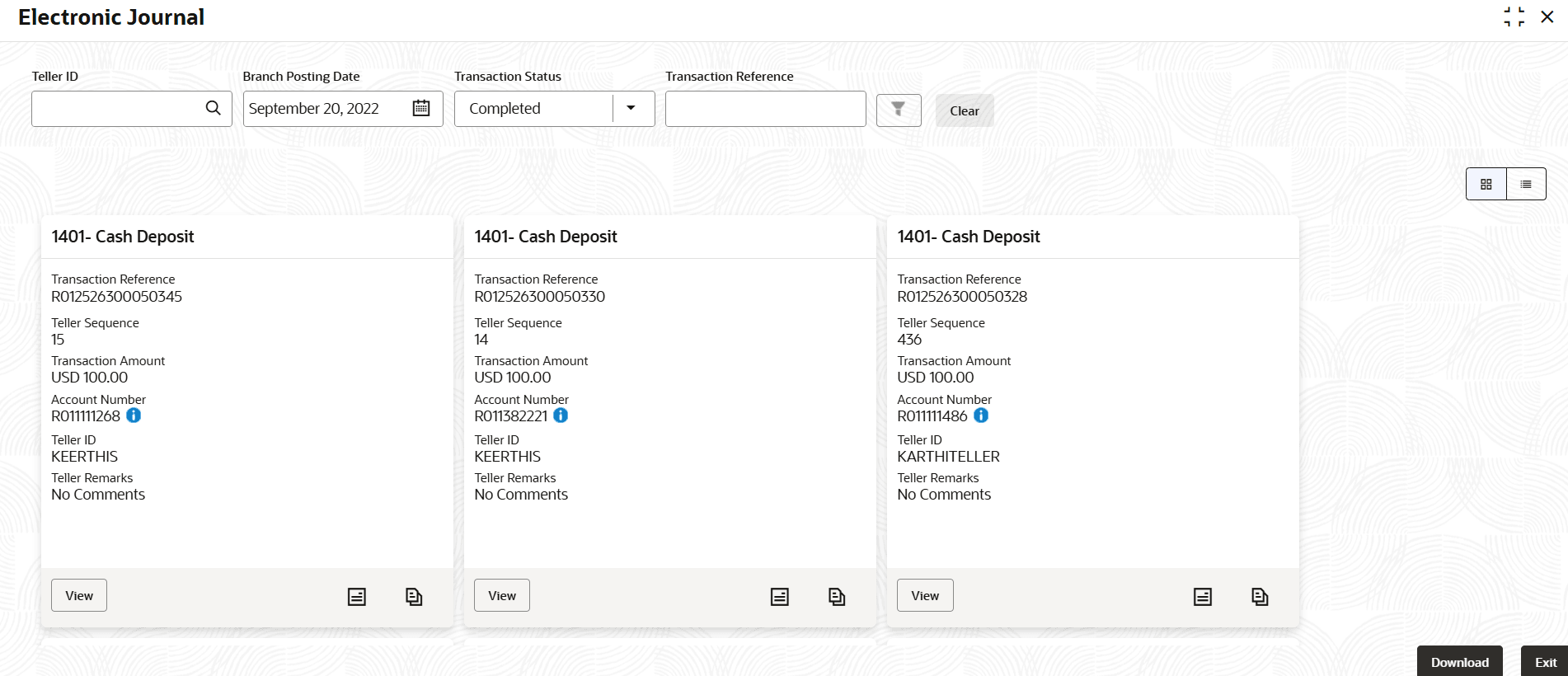

    Figure 6-3 Electronic Journal (List View) - Completed Transaction Status
    Figure 6-4 Electronic Journal (List View) - Sent Back Transaction Status
    User can perform any of the following actions in this screen:
    • Click Transaction Info icon to view the transaction information. This screen provides the details of the transactions handed off to the external system.
      The Transaction Info pop-up screen is displayed.
    • Click View button to view the transaction details. The following details are displayed based on the transaction status in the filters:
      • Transaction Reference
      • Transaction Status
      • Time Stamp
      • Teller ID
      • Teller Remarks
      • Approval Time Stamp
      • Supervisor ID
      • Supervisor Remarks
      • Override Info Override Info
        Click Override Info icon to view the details for approval flow request.
    • Click Submit Transactionicon to submit the transaction.
    • Click Discard Transactionicon to discard the transaction.
    • Click View Advice icon to view advice.
    • Click Reverse Transaction icon to reverse the transaction.
