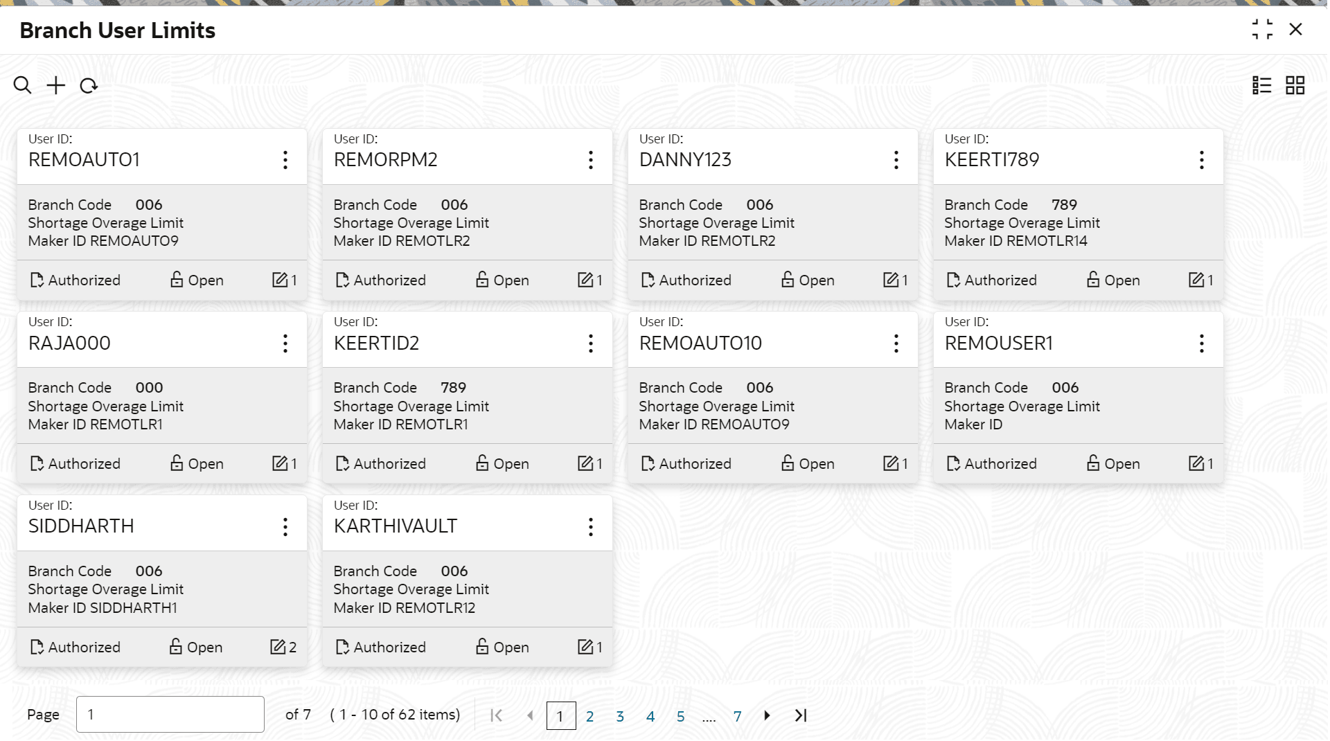

  1. On the Homepage, from Teller mega menu, under Branch Maintenance, click Branch User Limits or specify Branch User Limits in the search bar and select the screen.
    The Branch User Limits summary screen is displayed.
    Figure 10-5 Branch User Limits (Summary)

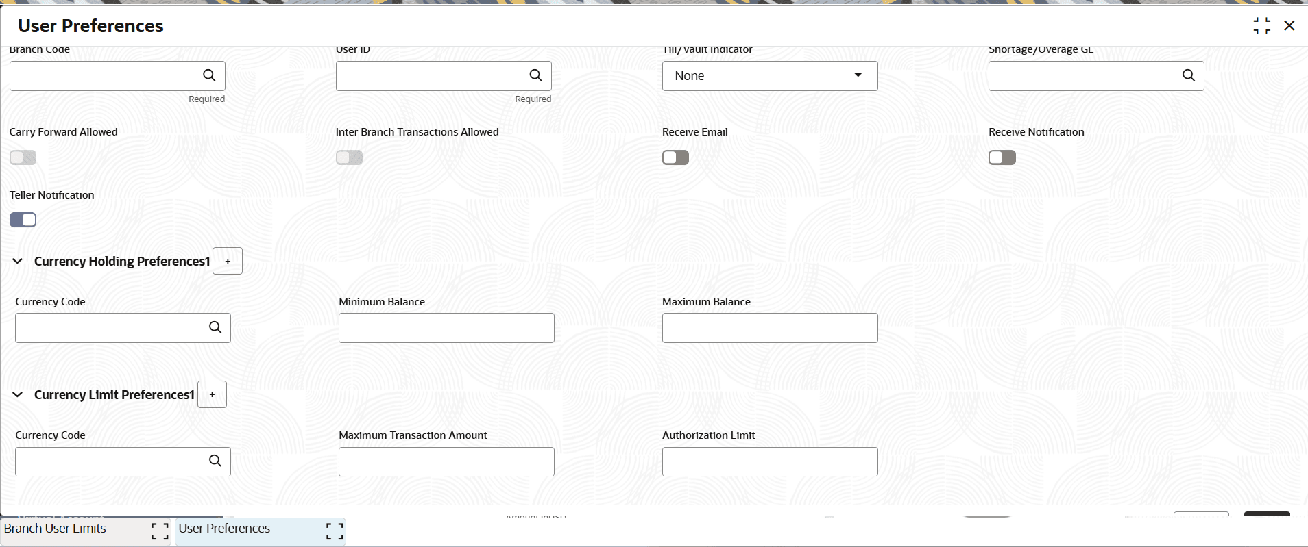

  2. Click the Add icon icon.
    The User Preferences screen is displayed.
  3. On the User Preferences screen, specify the fields. For more information on fields, refer to the field description table.
    The fields marked as Required are mandatory.
    Table 10-6 User Preferences - Field Description
    Field Description
    Branch Code
    Click Search icon, and select the branch code from the list of values.
    User ID
    Click Search icon, and select the user ID for which the branch preferences are to be maintained.
    Till/Vault Indicator
    Select from the following drop-down values:
    • Till
    • Vault
    • Both
    • None
    Shortage/Overage GL
    Note: Currently not used, meant for future use.
    Carry Forward Allowed
    Select if the funds are allowed to carry forward for the next day.
    Inter Branch Transactions Allowed
    Select if the transfer between the branches is allowed.
    Receive Email
    Select if the Teller needs to receive emails for approval of transactions.
    Receive Notification
    Select if the Teller needs to receive notifications in Dashboard
    Teller Notification
    Select Teller Notification if the Teller needs to receive notifications in Dashboard.
    Currency Holding Preferences
    Specify the fields.
    Currency Code
    Click Search icon, and select the currency code to specify the cash holding preferences.
    Minimum Balance
    Specify the minimum balance to be maintained for the Till or Vault.
    Maximum Balance
    Specify the maximum balance to be maintained for the Till or Vault.
    Currency Limit Preferences
    Specify the fields.
    Currency Code
    Click Search icon, and select the currency in which the limits (transactions amounts) will be expressed.
    Max Transaction Amount
    Specify the maximum transaction amount allowed that the user can enter in a single transaction.
    Authorization Limit
    Specify the maximum amount that the user (to which the limit role is associated) is allowed to process while authorizing a transaction.
