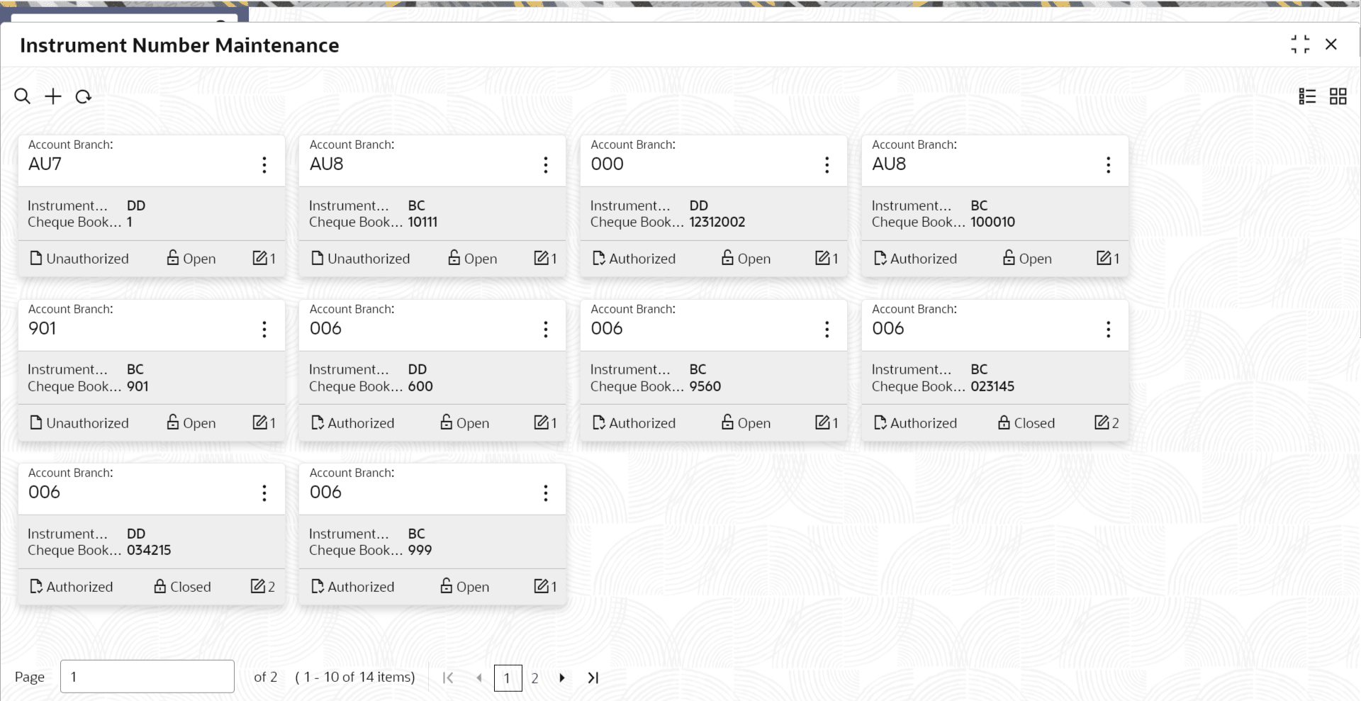

  1. On the Homepage, from Teller mega menu, under Branch Maintenance, click Instrument Number Maintenance or specify Instrument Number Maintenance in the search bar and select the screen.
    The Instrument Number Maintenance summary screen is displayed.
    Figure 10-21 Instrument Number Maintenance (Summary)

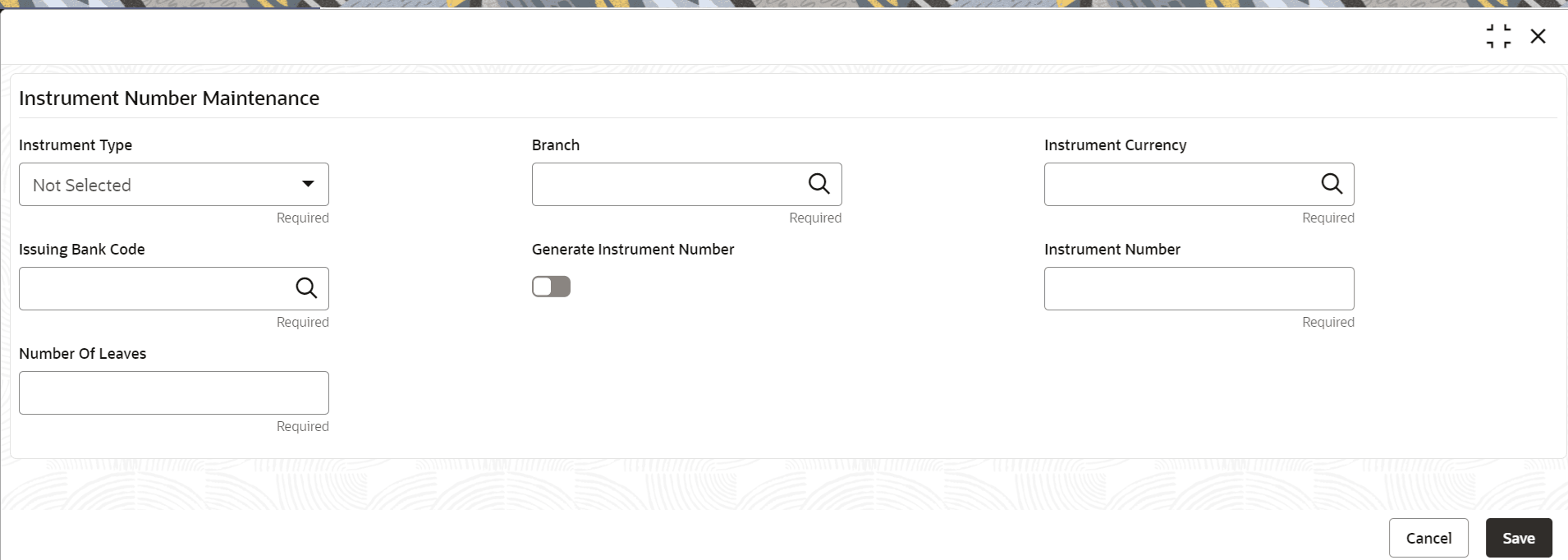

    The Instrument Number Maintenance (New) screen is displayed.
  3. On the Instrument Number Maintenance screen, specify the fields. For more information on fields, refer to the field description table.
    The fields marked as Required are mandatory.
    Figure 10-22 Instrument Number Maintenance (New)
    Table 10-16 Instrument Number Maintenance - Field Description
    Field Description
    Instrument Type
    Specify the instrument type for which the instrument maintenance needs to be done. Select the type of Instrument Type from below values:
    • Demand Draft
    • Bankers Check
    • Demand Draft-FCY
    Branch
    Select the branch code from the list of values.
    Instrument Currency Click Search icon and select the currency code from the list of values.
    Issuing Bank Code Click Search icon and select the bank code from the list of values.
    Generate Instrument Number
    Specify Generate Instrument Number as Yes/No by selecting the radio-button.
    When Instrument Number generation mode is set to Manual in OBPM.
    • If Instrument Number should be auto Generated by Branch during DD Issuance. Then the Generate instrument number should be enabled in Instrument Number Maintenance in OBBRN.
    • If Instrument Number should be manually input by Branch User during DD Issuance. Then the Generate instrument number should be disabled in Instrument Number Maintenance in OBBRN.
    Instrument Number
    Specify the Check number for which the instrument maintenance needs to be done.
    Number of Leaves
    Specify the number of leaves.
  4. Click Save.
    The summary view is displayed with the configured instrument number.
