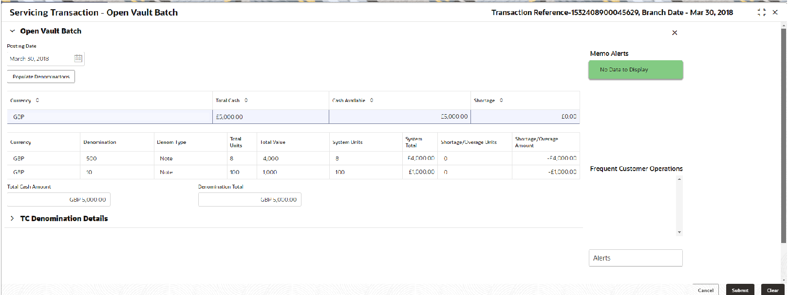

The Vault Teller can use Open Vault Batch screen to open a vault batch on a specified date.
On the specified posting date, the Vault Teller can open only one vault batch. To open another vault batch, the vault batch which is opened previously needs to be closed. All the tellers buy additional cash and sell their excess cash to the Vault Teller. When this screen is launched, the system will default the cash balances.

  1. On the Home screen, from Teller mega menu, under Branch Operations, click Open Vault Batch or specify Open Vault Batch in the search bar and select the screen.
    The Open Vault Batch screen is displayed.
  2. On the Open Vault Batch screen, specify the fields. For more information on fields, refer to the field description table.

    Populate Denominations Click Populate Denominations button to automatically populate total units using data from the previous closing balance. If it is not selected, the users must manually input the total units to proceed.

    Validate Denominations Click this button to calculate and display the Total Cash and Shortage or Overage Amount fields based on the currency selected.
  3. Click Submit.
    The vault batch is opened for the specified posting date.
    During the vault batch opening, the system will internally transfer the available balance from the Primary vault of the branch to the current open Vault ID. The Vault Teller can perform the relevant vault operations for the posting date. The system does not allow to open the vault batch if the physical cash entered is not the same as the system cash.
