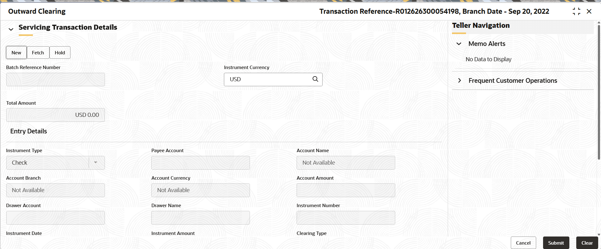

    Figure 4-5 Outward Clearing Data Entry
  2. On the Outward Clearing Data Entry screen, specify the fields. For more information on fields, refer to the field description table.
    The fields marked as Required are mandatory.
    Table 4-5 Outward Clearing Data Entry - Field Description
    Field Description
    New
    Click New to create a new clearing transaction and generate the batch reference number.
    Fetch
    Click Fetch to enable the field Batch Reference Number and input or select from the list of values. The list of values fetches only the batches that are saved and not submitted.
    Hold
    Click Hold to save the data entry made as part of the specified batch number.
    Displays the unique batch number, which is system generated.
    Instrument Currency
    Displays the current logged branch currency.
    User can also select the instrument currency from the drop-down values.
    Total Amount
    Displays the total batch amount in instrument currency.
    Entry Details
    Specify the fields.
    Payee Account
    Specify the payee account number.
    Account Name
    Displays the name of the payee account number specified.
    Account Currency
    Displays the currency of the payee account number specified.
    Account Branch
    Displays the branch code of the payee account number specified.
    Instrument Type
    Select the instrument type from the drop-down values.
    Drawer Account
    Specify the drawer account number.
    Drawer Name
    Specify the name of the drawer account.
    Instrument No
    Specify the instrument number.
    Instrument Date
    Specify the date of the instrument.
    Instrument Amount
    Specify the amount of the instrument.
    Clearing Type
    Select the clearing type for the deposited instrument.
    Drawer Routing No
    Specify the routing number of the check.
    You can also select from the list of values.
    Narrative
    Displays the default narrative as Outward Clearing Data Entry, and it can be modified.
    Add Entry
    Click Add Entry to add multiple records in the table, and it allows modifying or deleting if required.
    Reset
    Click Reset to clear the inputted entry details before you add the entries.
