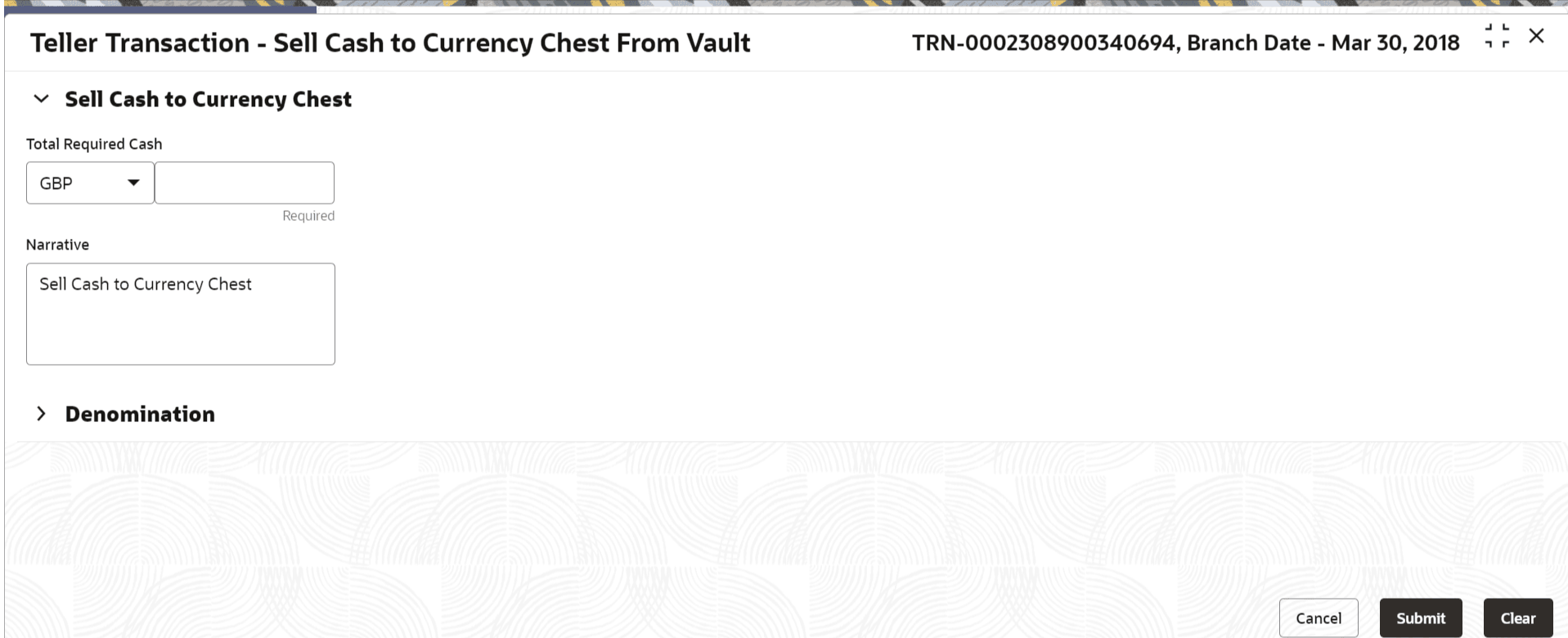

  1. On the Homescreen , from Teller mega menu, under Till-Vault Operations, click Sell Cash to Currency Chest or specify Sell Cash to Currency Chest in the search icon bar and select the screen.
    The Sell Cash to Currency Chest screen is displayed.
    Figure 11-6 Sell Cash to Currency Chest
  2. On the Sell Cash to Currency Chest screen, specify the fields. For more information on fields, refer to the field description table.

    Note: By default, the system displays the local currency of the branch. The user can select another currency from the drop-down values in which cash needs to be sold to the currency chest.
    Narrative Displays the default narrative Sell Cash to Currency Chest, and it can be modified.
