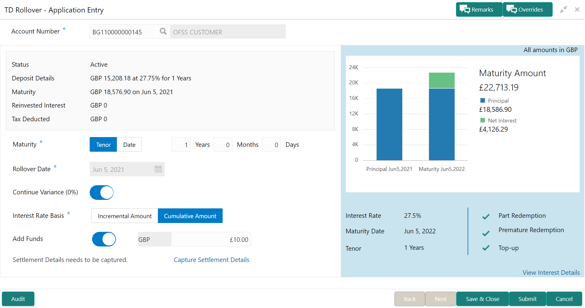

  2. Click the Search icon or specify the account number in the Account Number field, and press Enter or Tab.
    The details are displayed in the screen.
    Figure 2-31 TD Rollover – Application Entry - Deatils
    Description of Figure 2-31 follows
    Description of "Figure 2-31 TD Rollover – Application Entry - Deatils"
  3. On the Rollover screen, maintain the required details. For more information on fields, refer to the field description table.
    Table 2-23 TD Rollover – Application Entry – Field Description
    Field Description
    Account Number
    Click the Search icon and select the account number or specify the account number to perform TD rollover.
    The account holder name is displayed adjacent to this field.
    Status
    Displays the status of the TD. The possible options are:
    • Active
    • Overdue
    • Closed
    Deposit Details
    Displays the principal balance of the TD, the rate of interest, and the tenor of the TD.
    Maturity
    Displays the proceeds due to the customer on maturity and the maturity date.
    Reinvested Interest or Paid out interest
    Displays the amount and currency for the reinvested or paid out interest.
    • If the interest if of reinvest type, then the field name is displayed as Reinvested Interest.
    • If the interest if of paid out type, then the field name is displayed as Paid out Interest.
    Tax Deducted
    Displays the actual tax deducted on reinvested or paid out interest till date.
    Maturity
    Select the option for providing the maturity rollover TD. The options are:
    • Tenure: If you select this option, specify the tenure in Years, Months, and Days field.
    • Date: If you select this option, specify or select the date from the field displayed adjacent.
    Rollover Date
    Display the rollover deposit opening date. This date will be the maturity date of the existing TD.
    Continue Variance
    Switch to Toggle On to continue the interest variance to the rolled-over TD.
    Switch to Toggle Off to stop the continuation of interest variance to the rolled-over TD.
    Interest Rate Basis
    Select basis for the interest rate. The options are:
    • Incremental Amount
    • Cumulative Amount
    Add Funds
    Switch to Toggle On to add additional funds to the rollover.
    Switch to Toggle Off to not to add additional funds to the rollover.
    If you switch to Toggle On, then specify the amount in the field adjacent.
    Settlement Details needs to be captured.
    Displays the Capture Settlement Details link for capturing the settlement details for the rollover. For more information on settlement, refer Settlement Details.
    This field is displayed, if you switch to Toggle On from the Add Funds field.

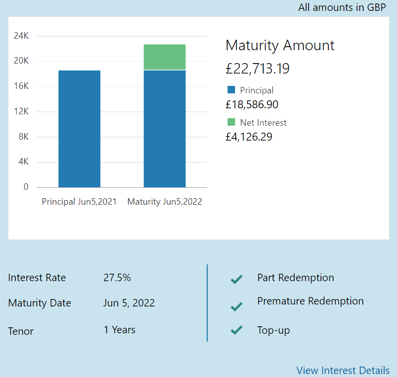

    • View Simulated Output: As you specify the amount in the Top-up Amount field, the simulated output details are displayed.
      Based on the input data provided, the system simulates the details of TD and displays them in a widget on the right side.
    Table 2-24 Output Details - Field Description
    Field Description
    Maturity Amount
    Displays the maturity amount for the rollover TD.
    Principal
    Displays the total principal of the rolled over.
    Net Interest
    Displays the net interest on the principal. (Interest - Tax)
    Interest Rate
    Displays the interest rate applicable for the rolled-over deposit.
    Maturity Date
    Displays the maturity date of the rolled-over TD.
    Tenor
    Displays the tenor of the rolled-over deposit in Years, Months, and Days.
    Part Redemption
    Displays whether the part redemption is allowed for the deposit.
    Premature Redemption
    Displays whether the premature is allowed for the deposit.
    Top-up
    Displays whether the top-up is allowed for the deposit.
    View Interest Details
    Click the link if the interest details need to be viewed.
    Date
    Displays the date of interest payout/compounding date.
    Displays the reinvested interest/paid-out interest.
    Principal
    Displays the principal after the interest liquidation on this date.

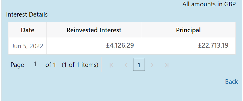

    • View Interest Details: You can view the interest details by clicking the View Interest Details link.
      The Interest Details section is displayed.
    Figure 2-33 View Interest Details
    Description of Figure 2-33 follows
    Description of "Figure 2-33 View Interest Details"
    Table 2-25 Interest Details – Field Description
    Field Description
    Date
    Displays the date as of which the interest amount is applicable.
    Reinvested Interestor Paid out Interest
    Displays the interest amount computed as of the date.
    Principal
    Displays the principal balance taking into consideration the effect of the interest for that date (if it is a re-invest kind of TD).
    • Click the Back link to view the simulation details.
