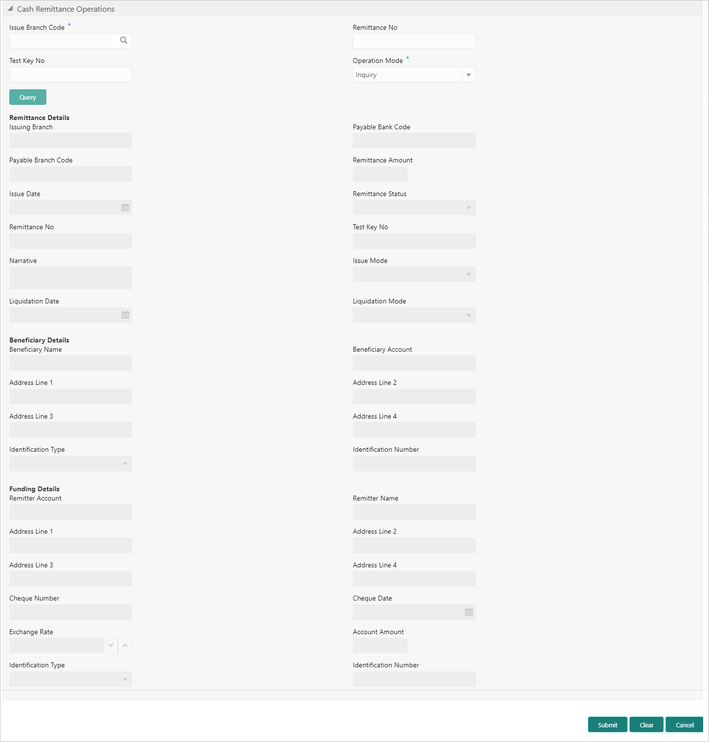

The Teller can use the Cash Remittance Operations screen to inquire about the details of the issued cash remittance.
When you select the operation mode as Inquiry, the fields related to cash remittance inquiry will be displayed.
To inquire about the details of cash remittance:

Figure 8-49 Cash Remittance Operations (Inquiry)
- On the Cash Remittance Operations screen, specify the
fields. For more information on fields, refer to the field description
table.
The fields, which are marked with an asterisk, are mandatory.Table 8-47 Cash Remittance Operations (Inquiry) - Field Description
