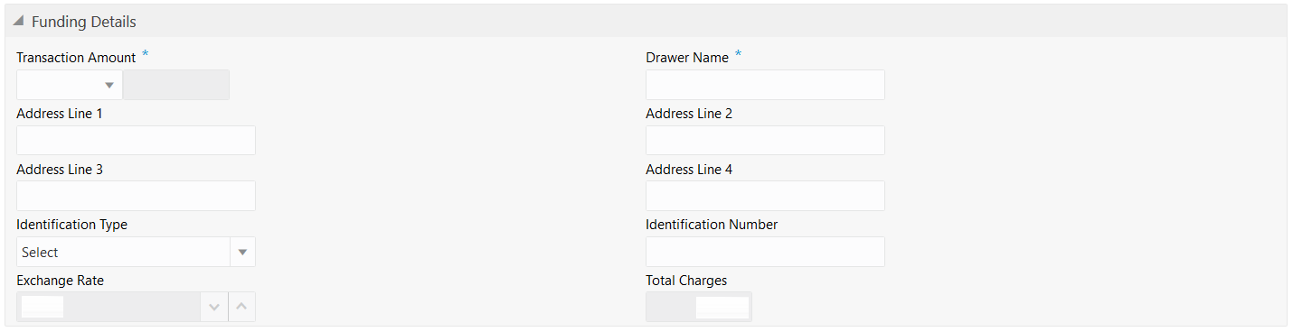

- Click on the Funding Details data segment.The Funding Details data segment is displayed.
- On the Funding Details data segment, specify the fields.
For more information on fields, refer to the field description
table.
The fields, which are marked with an asterisk, are mandatory.Table 8-26 Funding Details - Field Description
Field Description Transaction Amount
Specify the transaction currency, the currency in which the walk-in customer deposit the cash.
Drawer Name
Specify the name of the drawer.
Address Line 1 to Address Line 4
Specify the address of the payee.
Identification Type
Select the identification type of the payee from the drop-down list.
Identification Number
Specify the identification details of the payee.
Exchange Rate
Displays the exchange rate.Note:
If the transaction currency is the same as the account currency, the system will display the exchange rate as 1. This field is displayed only ifMulti-Currency Configurationat the Function Code Indicator level is set as Y.Total Charges
Displays the total charges applicable for the DD issuance.Note:
This field is displayed only ifTotal Charges Configurationat Function Code Indicator level is set as Y. - Specify the denomination details. For information on the fields in the Denomination Details segment, refer to Add Denomination Details.
