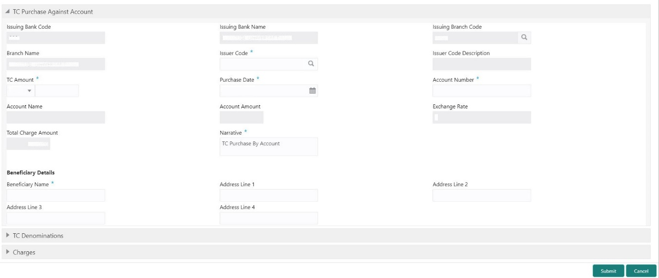

The Teller can use the TC Purchase Against Account screen to purchase TC from a customer and the credit the equivalent amount to the customer account.
- On the Homepage, from Teller mega menu, under Remittances, click TC Purchase Against Account or specify TC Purchase Against Account in the search icon bar and select the screen.The TC Purchase Against Account screen is displayed.
- On the TC Purchase Against Account screen, specify the
fields. For more information on fields, refer to the field description
table.
The fields, which are marked with an asterisk, are mandatory.Table 8-61 TC Purchase Against Account - Field Description
Field Description Issuing Bank Code
Specify the code of the issuing bank.Note:
By default, the logged-in bank code is displayed.Issuing Bank Name
Displays the name of the issuing bank specified.
Issuing Branch Code
Specify the code of the issuing branch.Note:
By default, the logged-in branch code is displayed.Branch Name
Displays the name of the issuing branch specified.
Issuer Code
Click the search icon and select the issuer code from the list of values.Note:
The list of values provides the HO code of the logged-in branch and the issuer codes maintained in the Issuer Code Maintenance screen.Issuer Code Description
Displays the description of the specified Issuer Code.
TC Amount
Select the TC currency from the drop-down values, and specify the TC Amount.
Purchase Date
Select the purchase date of the TC.Note:
By default, the current posting date is displayed.Account Number
Specify the account number of the Customer. When you press the Tab key, the system defaults the Account Name.
Account Name
Displays the name of the account.
Account Amount
Displays the account amount based on the Exchange Rate, TC Amount, and Account Number selected.
Exchange Rate
Displays the exchange rate.Note:
If the TC currency is the same as the account currency, the system displays the exchange rate as 1. This field is displayed only ifMulti-Currency Configurationat the Function Code indicator level is set as Y.Total Charge Amount
Displays the total charges in the branch local currency.Note:
This field is displayed only ifMulti-Currency Configurationat the Function Code indicator level is set as Y.Narrative
Displays the narrative as TC Sale Against Account, and it can be modified. Beneficiary Details
Specify the fields under this section.
Beneficiary Name
Specify the name of the beneficiary.
Address Line 1 to Address Line 4
Specify the address of the beneficiary.
- Specify the TC denomination details. For information on the fields in the TC Denominations segment, refer to Add TC Denominations to Purchase TC.
- Specify the charge details. For information on the fields in the Charge Details segment, refer to Add Charge Details.
- Click Submit.A teller sequence number is generated, and the Transaction Completed Successfully information message is displayed.
The transaction is moved to authorization in case of any approval warning raised when the transaction saves.The following conditions apply for the TC status:-
If the system finds the TC for the combination of TC Currency, Issuer Code, TC Denom Code, Series, and TC Number, the TC status will be updated to Purchased.
If the record is not found for the above-mentioned combination, during transaction completion, the system creates individual TC records for the combination of TC Currency, Issuer Code, TC Denom Code, Series, and TC Number with TC status as Purchased.
