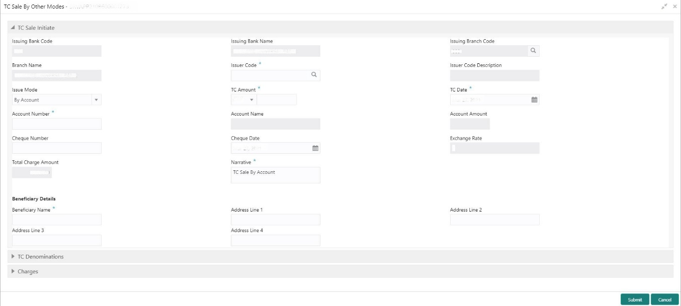

The Teller can use the TC Sale by Other Modes screen to issue TC against the customer's CASA or a GL account.
- On the Homepage, from Teller mega menu, under Remittances, click TC Sale by Other Modes or specify TC Sale by Other Modes in the search icon bar and select the screen.The TC Sale by Other Modes screen is displayed.
- On the TC Sale by Other Modes screen, specify the
fields. For more information on fields, refer to the field description
table.
The fields, which are marked with an asterisk, are mandatory.Table 8-58 TC Sale by Other Modes - Field Description

- Specify the TC denomination details. For information on the fields in the TC Denominations segment, refer to Add TC Denominations to Sell TC.
- Specify the charge details. For information on the fields in the Charge Details segment, refer to Add Charge Details.
- Click Submit.A teller sequence number is generated, and the Transaction Completed Successfully information message is displayed.
The transaction is moved to authorization in case of any approval warning raised when the transaction saves. On transaction submission, the TC position (TC outflow) is updated to the teller position for the combination of Issuer Code, TC Currency, TC Denom code, and Series to the extent of TC denomination units being purchased.In addition, during transaction completion, the system updates the TC Status as Used for the combination of TC Currency, Issuer Code, TC Denom Code, Series, and TC Number. Following main transaction accounting entries is triggered for Account mode at Oracle Banking Branch:
