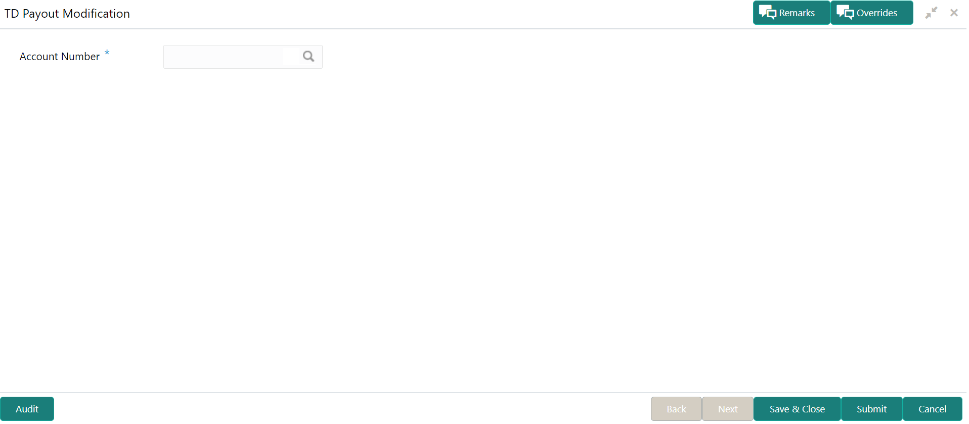

You can view or modify the payout instructions maintained during the TD account opening using this screen. Also, you can create new payout instruction, if no instructions are maintained for the TD account.
The fields, which are marked with an asterisk, are mandatory.- On the Homepage, from the Deposit
Services mega menu, under Term Deposits
and Maintenance, click Payout
Modification, or specify Payout
Modification in the search icon bar and select the screen.
The Term Deposit Payout Modification screen is displayed.
Figure 3-7 Term Deposit Payout Modification
Description of "Figure 3-7 Term Deposit Payout Modification" - On the Term Deposit Payout Modification screen, click
the
icon or specify the account number in the Account

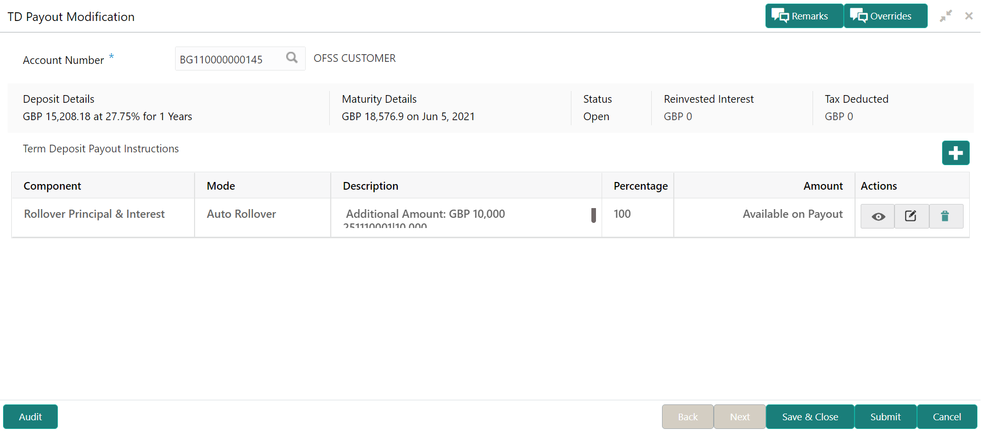

Number field.The details are displayed.Figure 3-8 Term Deposit Payout Modification Details
Description of "Figure 3-8 Term Deposit Payout Modification Details" - You can view the payout details of the TD account.For more information on fields, refer to the field description
table.
Table 3-4 View TD Payout Details – Field Description
Field Description Account Number
Click the
icon and select the account number or specify
the account number to modify the TD payout.
The account holder name is displayed adjacent to this field.Deposit Details
Displays the principal balance, the rate of interest, and the tenor of the TD account.
Maturity Details
Displays the amount due to the customer on maturity and the maturity date.
Status
Displays the status of the TD account. The possible options are:- Active
- Overdue
- Closed
Reinvested Interest or Interest Paid
Displays the amount and currency for the reinvested or paid out interest. Note:
- If the interest if of reinvest type, then the field name is displayed as Reinvested Interest.
- If the interest if of paid out type, then the field name is displayed as Interest Paid.
Tax Deducted
Displays the tax amount deducted till date.
Term Deposit Payout Instructions
This section displays the existing payout instructions of the TD account.
Component
Displays the component of payout. The possible options are:- Principal
- Interest
- Principal & Interest
- Rollover Principal
- Rollover Interest
- Rollover Principal & Interest
Mode
Displays the mode of payout. The possible options are:- Account
- Term Deposit
- Auto Rollover
- Banker's Cheque
- Demand Draft
- Ledger
Description Displays a brief description of the payout.
Based on the payout mode, the description is displayed. The description according to the mode are as follows:- Account – Account Number & Account Name
- Term Deposit – Product Name, Tenor
- Auto Rollover – Tenor
- Banker’s Cheque & Demand Draft – Banker’s Cheque / Demand Draft Payable at <Branch Name>
- Rollover with Additional Funds – Tenor, Additional Amount, Account Number, Amount
- Ledger – Ledger Code, Ledger Name
Percentage Displays the percentage of payout.
Amount Displays the TD payout amount.
For Interest component, this field displays Available on Payout text.Actions Click the
icon, to more details of the payout. For more
information, refer View TD Payout Modification.
Click the
icon, to edit the payout details. For more
information, refer Modify TD Payout
Modification.
Click the
icon, to delete the payout details.
- Click Submit.The screen is successfully submitted for authorization.
- View TD Payout Modification
You can view the more details of the TD payout modification. - Modify TD Payout Modification
You can modify the TD payout details.
