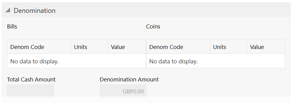

Figure 2-14 Denomination Details
Validate the denomination details. For more information on fields, refer to the field description table.
Table 2-14 Denomination Details - Field Description
Field Description
Denom Code
Displays the unique denomination codes for each currency.
Units
Indicates the number of units for the specified denomination.
By default, the till contents are incremented for inflow transactions such as cash deposits and decremented for outflow transactions such as cash withdrawal. To reverse the transaction, you can specify units in negative.
Value
Displays the system-computed face value of the denomination based on the number of units.
For example, if the denomination code represents USD 100 and the unit is specified as 3, the value will be displayed as 300.
Denomination Amount
Displays the system-computed value of the denomination by multiplying the denomination value with the number of units.
For example, if the denomination code represents USD 100 and the number of units is 10, the denomination amount will be 1000.
Total Cash Amount
Displays the total cash amount.
The system computes the Denomination Amount and validates the amount if it is equal to the Total Cash Amount. It also prompts an error during saving if there is any difference.
