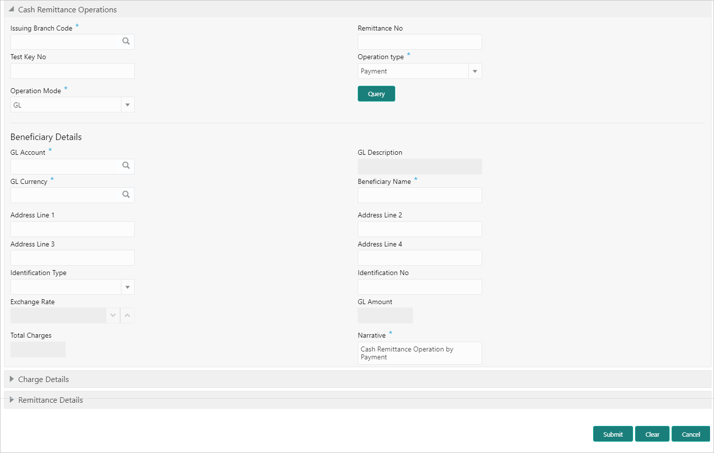

Figure 8-52 Cash Remittance Operations (Payment by GL)
- On the Cash Remittance Operations screen, specify the
fields. For more information on fields, refer to the field description
table.
The fields, which are marked with an asterisk, are mandatory.Table 8-50 Cash Remittance Operations (Payment by GL) - Field Description
Field Description Issuing Branch Code
Select the branch code where the remittance is issued.
Remittance No
Specify the remittance number of the instrument.
Test Key No
Specify the test key number.
Operation Type
Select the type Payment from the drop-down list.
Operation Mode
Select the operation mode as GL from the drop-down values.
Query
Click Query to fetch the remittance details.Note:
When you click this icon, after you specify the Issue Branch Code and Remittance No, the system will make a service call to Oracle Banking Payments and fetch the remittance details.Beneficiary Details
Specify the details under this segment.
GL Account
Specify the GL account number.
GL Description
Displays the description of the specified GL account number.
GL Currency
Displays the branch local currency of the specified GL account.Note:
You can also select a currency from the list of values.Beneficiary Name
Specify the beneficiary name.
Address Line 1 to Address Line 4
Specify the address of the beneficiary.
Identification Type
Select the identification type of the beneficiary from the drop-down values.
Identification Number
Specify the identification number of the beneficiary.
Exchange Rate
Displays the exchange rate, and it can be modified.Note:
If the transaction currency is the same as the account currency, the system will display the exchange rate as 1. This field is displayed only ifMulti-Currency Configurationat Function Code Indicator level is set as Y.GL Amount
Displays the GL amount.Note:
This field is displayed only ifMulti-Currency Configurationat Function Code Indicator level is set as Y.Total Charge Amount
Displays the total charge amount.Note:
This field is displayed only ifTotal Charges Configurationat Function Code Indicator level is set as Y.Narrative
Displays the default narrative as Cash Remittance Operation by Payment, and it can be modified.
