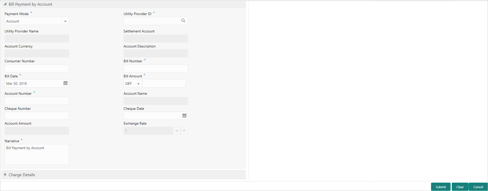

    By default, the system displays the Bill Payment by Account screen.
    Figure 13-2 Bill Payment by Account
  2. On the Bill Payment by Account screen, specify the fields. For more information on fields, refer to the field description table.
    The fields, which are marked with an asterisk, are mandatory.

  3. Specify the charge details. For information on the fields in the Charge Details segment, refer to Add Charge Details.
  4. Click Submit.
    A teller sequence number is generated, and the Transaction Completed Successfully information message is displayed.
    The transaction is moved to authorization in case of any approval warning raised when the transaction saves. On transaction completion, the main leg accounting (Dr Cash GL and Cr Institution ID account GL) and charge accounting details are handed off to the Accounting System.
