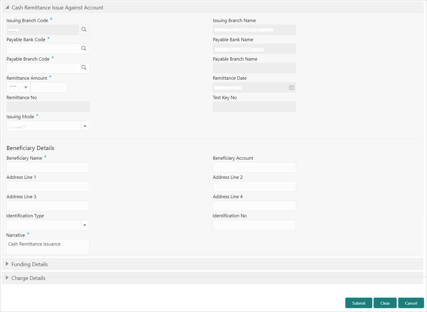

The Cash Remittance Issue Against Account screen is used to remit funds across branches of the same bank and across banks.
The cash remittance is performed against the remitter's account when the issuing mode is Account.
To perform cash remittance issue against account:
  1. On the Homepage, from Teller mega menu, under Remittances, click Cash Remittance Issue or specify Cash Remittance Issue in the search icon bar and select the screen.
    The Cash Remittance Issue Against Account screen is displayed.
    Figure 8-75 Cash Remittance Issue Against Account
  2. On the Cash Remittance Issue Against Account screen, specify the fields. For more information on fields, refer to the field description table.
    The fields, which are marked with an asterisk, are mandatory.
    Table 8-65 Cash Remittance Issue Against Account - Field Description
    Field Description
    Issuing Branch Code
    Displays the code of the home branch.
    Issuing Branch Name
    Displays the name of the issuing branch code.
    Payable Bank Code
    Select the payable bank code from the list of values.
    To remit funds within the same bank, select the logged-in bank code as payable bank code. To remit funds across banks, select the necessary bank code as payable bank code.
    Payable Bank Name
    Displays the name of the selected bank code.
    Payable Branch Code
    Select the branch code of the payable bank. The list of values contains the corresponding branches maintained for the payable bank code.
    Payable Branch Name
    Displays the branch name of the selected branch code.
    Remittance Amount
    Specify the cash remittance currency and amount, which needs to be transferred.
    Remittance Date
    Select the date of cash remittance.
    Remittance No
    Specify the cash remittance number.
    Test Key No
    Specify the test key number.
    Issue Mode
    Select the issue mode from the drop-down values (Account, Cash, or GL).
    Beneficiary Details
    Specify the fields.
    Beneficiary Name
    Specify the name of the beneficiary.
    Beneficiary Account
    Specify the account number of the beneficiary.
    Address Line 1 to Address Line 4
    Specify the address of the beneficiary.
    Identification Type
    Select the identification type.
    Identification No
    Specify the identification number.
    Narrative
    Displays the default narrative as Cash Remittance Issuance, and it can be modified.

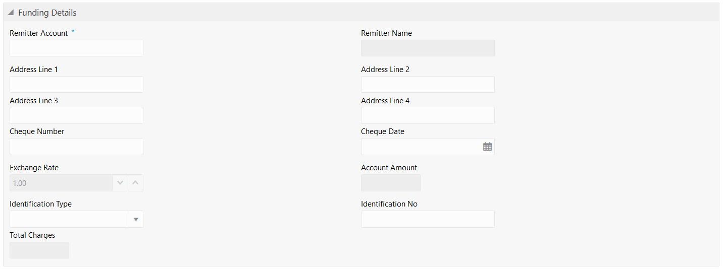

  3. Click on the Funding Details data segment.
    The Funding Details data segment is displayed.
  4. In the Funding Details data segment, specify the fields. For more information on fields, refer to the field description table.
    Table 8-66 Funding Details - Field Description
    Field Description
    Remitter Account
    Specify the remitter account number.
    Remitter Name
    Displays the name of the specified remitter account.
    Displays the address of the specified remitter account.
    Cheque Number
    Specify the cheque number.
    The system validates the status of the cheque and prompts an error message if incase of a Used or Stopped or Invalid cheque.
    Cheque Date
    Specify the issue date of the cheque.
    Exchange Rate
    Displays the exchange rate, and it can be modified.
    If the transaction currency is the same as the account currency, the system will display the exchange rate as 1. This field is displayed only if Multi-Currency Configuration at Function Code Indicator level is set as Y.
    Account Amount
    Displays the account amount.
    Identification Type
    Identification No
    Total Charges
    Displays the total charge amount.
    This field is displayed only if Total Charges Configuration at Function Code Indicator level is set as Y.
