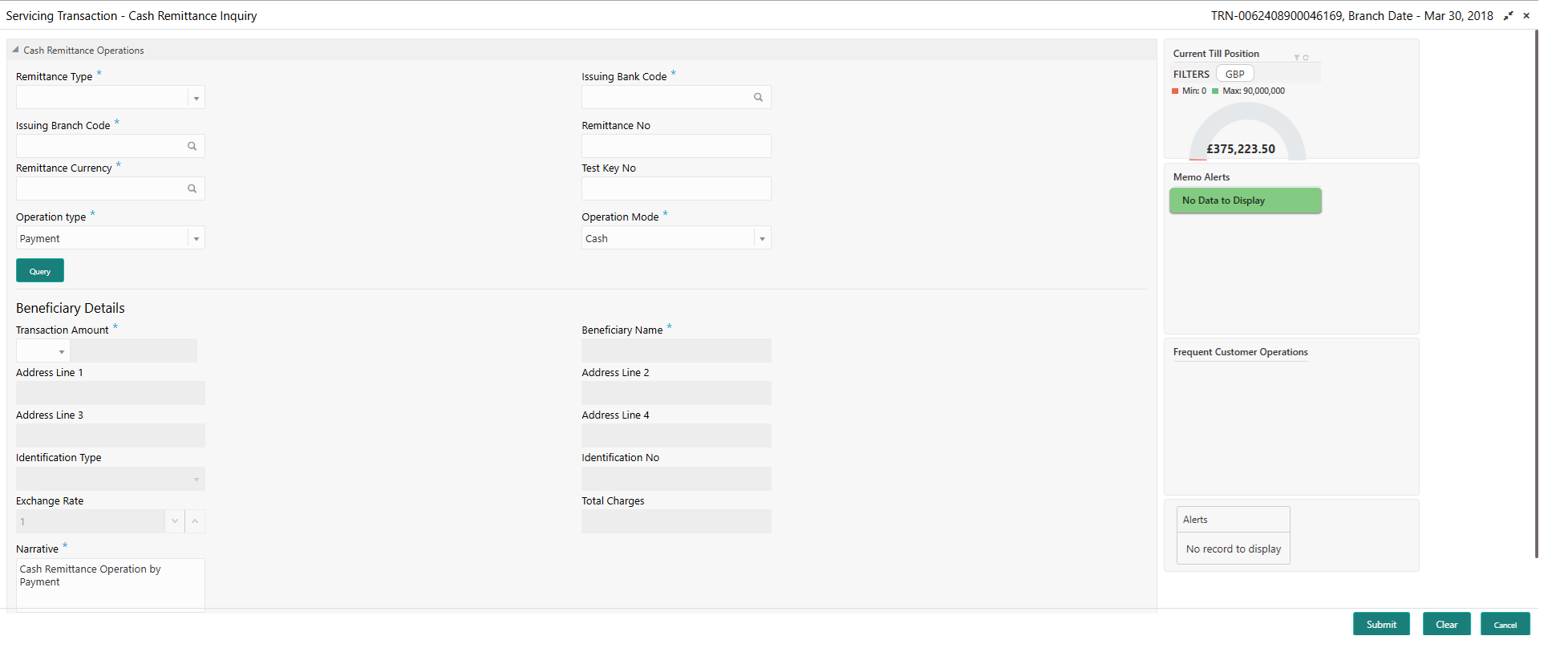

    Figure 8-83 Cash Remittance Operations (Payment by Cash)
  2. On the Cash Remittance Operations screen, specify the fields. For more information on fields, refer to the field description table.

  6. Click Submit.
    A teller sequence number is generated, and the Transaction Completed Successfully information message is displayed.
