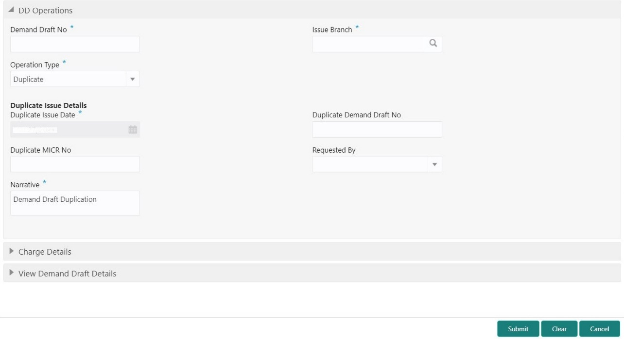

To issue a duplicate DD:
  1. On the Homepage, from Teller mega menu, under Remittances, click DD Operations or specify DD Operations in the search icon bar and select the screen.
    The DD Operations screen is displayed.
    Figure 8-58 DD Operations - Duplicate Issue
  2. On the DD Operations screen, specify the fields. For more information in the DD Operations screen, refer to Table 8-47
  3. Specify the charge details. For information on the fields in the Charge Details segment, refer to Add Charge Details.
  4. Click on the View Demand Draft Details data segment to view the additional details of the DD when the issue mode as GL.
    For more information on screen for the View Demand Draft Details data segment, refer to Figure 8-54.
  5. On the View Demand Draft Details screen, view the fields. For more information on field description for the View Demand Draft Details data segment, refer to Table 8-48.
  6. Click Submit.
    A teller sequence number is generated, and the Transaction Completed Successfully information message is displayed.
    The transaction is moved to authorization in case of any warning raised when the transaction saves.
