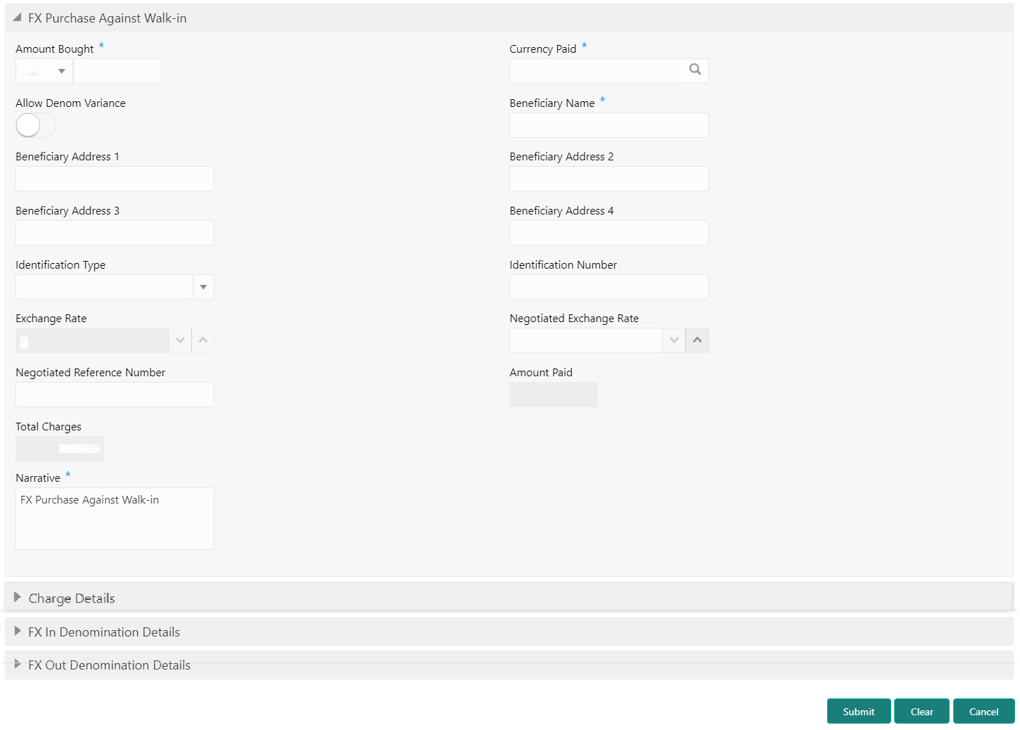

    Figure 4-9 FX Purchase Against Walk-in
  2. On the FX Purchase Against Walk-in screen, specify the fields. For more information on fields, refer to the field description table.
    Table 4-9 FX Purchase Against Walk-in
    Field Description
    Amount Bought
    Select the applicable currency from the drop-down list, and specify the amount bought from the walk-in customer.
    Currency Paid
    Select the currency that you have paid to the walk-in customer.
    You can select the appropriate code from the list of values that displays all the currency codes maintained in the system.
    Allow Denom Variance
    Select if the denomination-wise variance needs to be applied for the transaction.
    If the parameter at function code indicator is set as Y, this option will be selected by default, and it can be modified. If the parameter at the function code indicator is set as N, then this option will be disabled.
    Beneficiary Name
    Specify the name of the beneficiary walk-in customer.
    Beneficiary Address 1 to Beneficiary Address 4
    Specify the address of the beneficiary walk-in customer.
    Identification Type
    Select the type of identification provided by the walk-in customer from the drop-down list.
    Identification Number
    Specify the identification number provided by the walk-in customer.
    Negotiated Exchange Rate
    Specify the negotiated exchange rate if it is needed to perform the transaction using negotiated value.
    This field is applicable only if the transaction involves cross currency. If this option is selected, the Negotiated Reference Number field will become mandatory.
    Specify the reference number for the negotiated cost rate.
    Exchange Rate
    Displays the exchange rate used to convert the transaction currency into account currency, and it can be modified.
    This field is displayed only if Multi-Currency Configuration at Function Code Indicator level is set as Y.
    Amount Paid
    Displays the amount paid and currency to the customer.
    The currency of the amount paid is defaulted from the received currency. The Amount Paid will be calculated based on the Amount Bought and the Exchange Rate. This field is displayed only if Multi-Currency Configuration at Function Code Indicator level is set as Y.
    Total Charges
    Displays the total charge amount, which is computed by the system in the local currency of the branch.
    Narrative
    Displays the default narrative as FX Purchase (Walk-in), and it can be modified.
  3. Specify the charge details. For information on the fields in the Charge Details segment, refer to Add Charge Details.
  4. Specify the FX In Denomination details. For information on the fields in the FX In Denomination Details segment, refer to Add Denomination Details.
  5. Specify the FX Out Denomination details. For information on the fields in the FX Out Denomination Details segment, refer to Add Denomination Details.
  6. Click Submit.
    A teller sequence number is generated, and the Transaction Completed Successfully information message is displayed.
