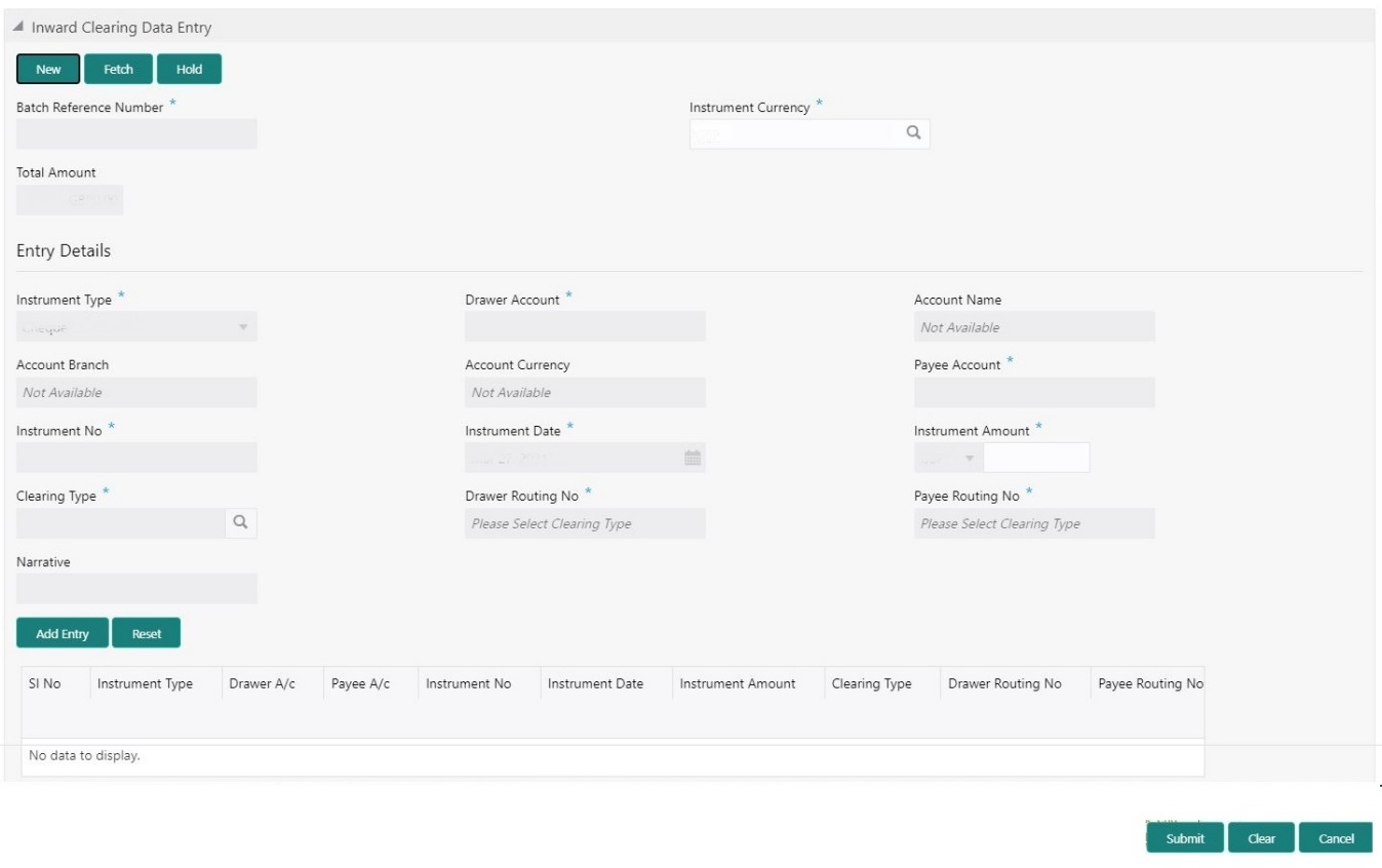

Inward Clearing Data Entry
The Teller can use the Inward Clearing Data Entry screen to initiate the inward processing of bulk instruments.
This screen supports to capture of bulk input of inward clearing transactions for multiple instrument types – Cheque, Bankers Cheque, and Demand Draft. It also supports bulk data entry of inward clearing transactions for single and multiple customer accounts.

    Figure 7-4 Inward Clearing Data Entry
  2. On the Inward Clearing Data Entry screen, specify the fields. For more information on fields, refer to the field description table.
    Table 7-4 Inward Clearing Data Entry - Field Description
    Field Description
    New
    Click New to create a new clearing transaction and generate the batch reference number.
    Fetch
    Click Fetch to enable the field Batch Reference Number and input or select from the list of values. The list of values fetches only the batches that are saved and not submitted.
    Hold
    Click Hold to save the data entry made as part of the specified batch number.
    Displays the unique batch number, which is system generated.
    Instrument Currency
    Displays the current logged branch currency.
    You can also select the instrument currency from the drop-down values.
    Total Amount
    Displays the total batch amount in instrument currency.
    Entry Details
    Specify the fields.
    Instrument Type
    Select the instrument type from the drop-down values.
    Drawer Account
    Specify the drawer account number.
    Account Name
    Displays the name of the account number specified.
    Account Branch
    Displays the branch code of the account number specified.
    Account Currency
    Displays the currency of the account number specified.
    Payee Account
    Specify the payee account number.
    You can also select from the list of values.
    Instrument No
    Specify the instrument number.
    Instrument Date
    Specify the date of the instrument.
    Instrument Amount
    Specify the amount of the instrument.
    Clearing Type
    Specify the clearing type.
    Drawer Routing No
    Specify the routing number.
    Payee Routing Number
    Specify the routing number of the cheque.
    Narrative
    Displays the default narrative as Inward Clearing Data Entry, and it can be modified.
    Add Entry
    Click Add Entry to add multiple records in the table and allow modifying or deleting if required.
    Reset
    Click Reset to clear the inputted entry details before you add the entries.
  3. Click Submit.
    A teller sequence number is generated, and the Transaction Completed Successfully information message is displayed.
    The transaction is moved to authorization in case of any warning raised when the transaction saves.
    On submission of data entry, the individual instrument details will be handed off to Oracle Banking Payments using Inward Clearing Service.
    In case of reject notification of any transaction from Oracle Banking Payments, the teller can either modify the data and resubmit the transaction or discard the data entry.
