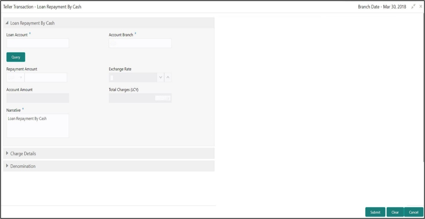

    Figure 11-2 Loan Repayment by Cash
  2. On the Loan Repayment by Cash screen, specify the fields. For more information on fields, refer to the field description table.
    Table 11-2 Loan Repayment by Cash - Field Description
    Field Description
    Loan Account
    Specify the loan account number. When you press the Tab key, the customer details and loan account details will be displayed in the Customer Information widget.
    Repayment Amount
    Select the repayment currency and specify the repayment amount.
    By default, the loan account currency is displayed as repayment currency.
    Account Branch
    Specify the branch code.
    Query
    Click this icon to fetch the details of loan account based on the branch code.
    Exchange Rate
    Displays the exchange rate.
    If the transaction currency is the same as the account currency, the system displays the exchange rate as 1. This field is displayed only if Multi-Currency Configuration at the Function Code indicator level is set as Y.
    Total Charges (LCY)
    Displays the total charges in the branch local currency.
    This field is displayed only if Total Charge Configuration at Function Code indicator level is set as Y.
    Account Amount
    Displays the repayment amount in loan account currency.
    This field is displayed only if Multi-Currency Configuration at Function Code indicator level is set as Y. If the loan account currency is different from repayment currency, then the system will derive the account amount based on the exchange rate.
    Narrative
    Displays the narrative as Loan Repayment By Cash, and it can be modified.
