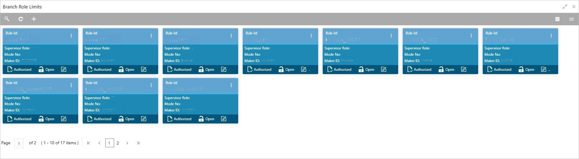

  1. On the Homepage, from Teller mega menu, under Branch Maintenance, click Branch Role Limits or specify Branch Role Limits in the search icon bar and select the screen.
    The Branch Role Limits summary screen is displayed.
