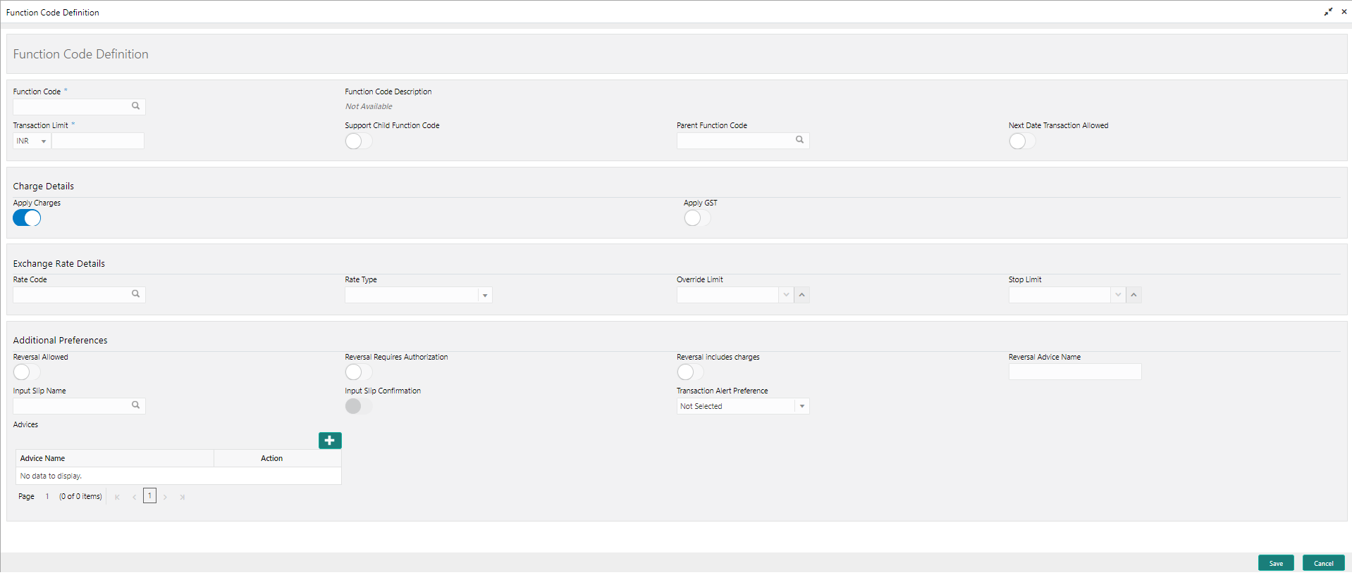

    The Function Code Definition (New) screen is displayed.
    Figure 20-10 Function Code Definition
    In Function Code Definition screen, reversal allowed flag will not be enabled for BC Payment Reversal, DD Payment Reversal, and Cash Remittance Reversal. The system displays an error message stating that the Reversal is not supported, making reversal allowed as N.
  3. On the Function Code Definition screen, specify the fields. For more information on fields, refer to the field description table.
    Table 20-10 Function Code Definition - Field Description
    Field Description
    Function Code
    Select from the list function codes that are factory shipped. For the list of function codes and the respective screen names, refer to List of Function Codes.
    Function Code Description
    Displays the description of the function code.
    Transaction Limit
    Specify the maximum transaction amount allowed for this function code in branch currency.
    Support Child Function Code
    Select if the specified function code needs to act as the parent function code.
    Parent Function Code
    Specify the applicable parent function code.
    This field is enabled only if the Support Child Function Code is not selected.
    Next Date Transaction Allowed
    Select if the next day transaction posting needs to be allowed for the specified function code.
    Charge Details
    Specify the fields.
    Apply Charges
    Specify if charges are applicable for this transaction.
    Apply GST Enable this toggle button to identify whether collection of a GST is applicable for a transaction.
    • This field is visible only when the Apply Charges field is enabled.
    • Maintain the value as "Y" for the parameter GST Enabled in the SRV_TM_BC_PARAM_DTLS table.
    Exchange Rate Details
    Specify the fields.
    Rate Type
    Select the rate type for the transaction code.
    Rate Code
    Select the rate code for the transaction code.
    Override Limit
    Specify the override limit. The system displays the default override limit currency as GBP.
    Stop Limit
    Specify the stop limit. The system displays the default stop-limit currency as GBP.
    Additional Preferences
    Specify the fields.
    Reversal Allowed
    Specify if the reversal is allowed for the transaction.
    Reversal allowed will be disabled for remittances and clearing transactions. Hence, reversal will not be enabled in the journal log.
    Reversal Requires Authorization
    Specify if the authorization is required for a reversal transaction.
    Reversal includes charges
    Specify if the charges are to be reversed along with transaction reversal.
    Reversal Advice Name
    Select the reversal advice name from the list of values.
    Input Slip Name
    Specify the input slip name.
    Input Slip Confirmation
    Select if the input slip confirmation is required for the transaction. If this option is selected for a transaction screen, the Input-Slip button will be displayed on the screen.
    On the specified transaction screens, you can click Input-Slip to view the input slip before transaction submission. Once you click Input-Slip, the system validates mandatory fields. In addition, you can perform any of the following actions:
    • Confirm and Print – This icon is enabled only if Input Slip Confirmation is selected in the Function Code Definition screen. In addition, the transaction can be submitted only if the receipt is confirmed. Click this button to confirm and print the receipt.
    • Print – Click Print to print the generated slip and provide it to the customer.
    • Close – Click Close to close the generated receipt.
    If the mandatory fields are not filled, the system shows an error message Value is required, wherever applicable.
    Transaction Alert Preference
    This field is meant for future use.
    Advices
    This section allows selecting advice for multiple Function Codes.
    Advice Name
    Displays the advice name.
