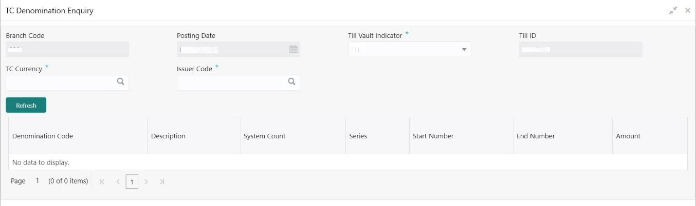

TC Denomination Enquiry
The TC Denomination Enquiry screen is used to enquire the currency-wise details of the TCs in the branch vault.
The currency-wise details include:
  • Denomination
  • Count
  • Series
  • Serial Number
  • Amount
To enquire the TC denomination:
  1. On the Homepage, from Teller mega menu, under Branch Operations, click TC Denomination Enquiry or specify TC Denomination Enquiry in the search icon bar and select the screen.
    The TC Denomination Enquiry screen is displayed.
    Figure 2-1 TC Denomination Enquiry
  2. On the TC Denomination Enquiry screen, specify the fields. For more information on fields, refer to the field description table.
    Table 2-1 TC Denomination Enquiry - Field Description
    Field Description
    Branch Code
    Displays the logged-in branch code.
    Posting Date
    Displays the current posting date of the branch.
    Till Vault Indicator
    Select the Till Vault Indicator from the drop-down values (Till or Vault).
    Till ID
    Displays the Till ID.
    TC Currency
    Click the search icon, and select the TC currency from the list of values.
    Issuer Code
    Click the search icon, and select the issuer code from the list of values.
    Refresh
    After you specify the TC Currency and Issuer Code fields, click Refresh to fetch and display the details of the TC.
    Denomination Code
    Displays the denomination code of the TC.
    Description
    Displays the description of the denomination code.
    System Count
    Displays the system count.
    Series
    Displays the series.
    Start Number
    Displays the start number.
    End Number
    Displays the end number.
    Amount
    Displays the amount.
