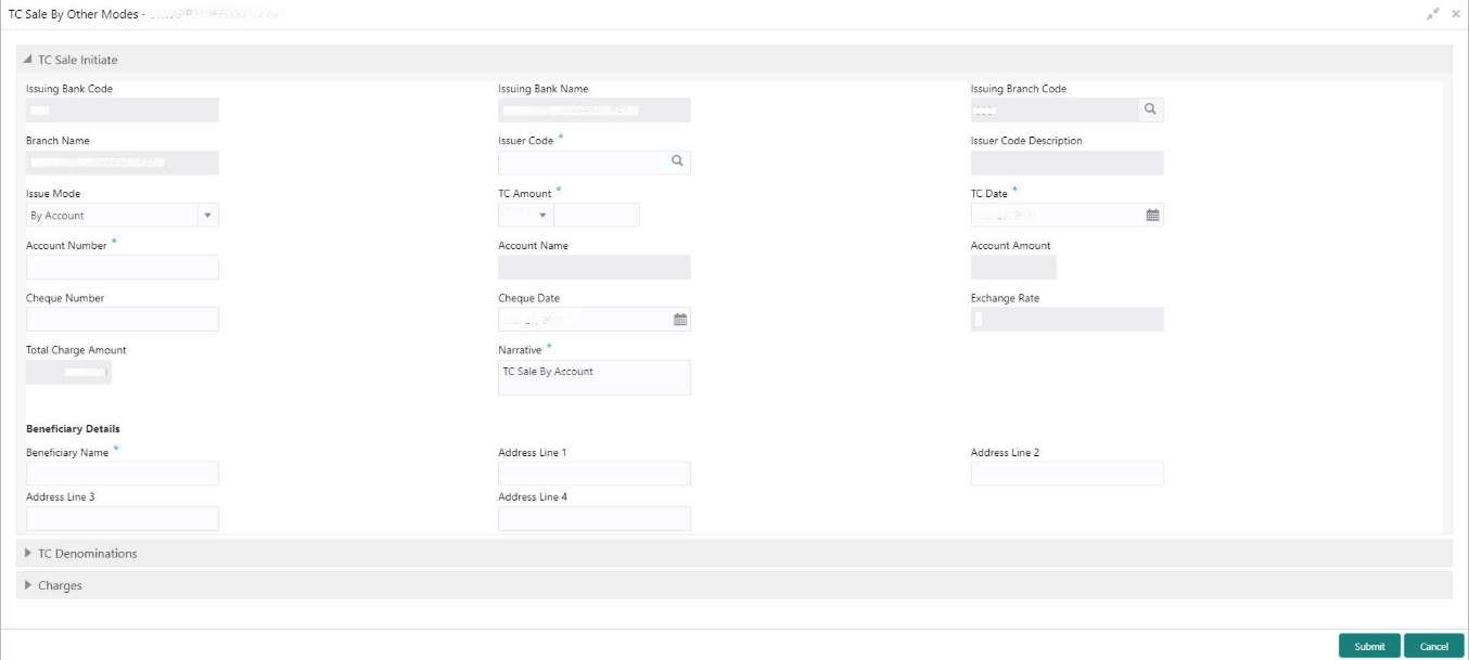

TC Sale by Other Modes
The Teller can use the TC Sale by Other Modes screen to issue TC against the customer's CASA or a GL account.
To issue TC against various modes:
  1. On the Homepage, from Teller mega menu, under Remittances, click TC Sale by Other Modes or specify TC Sale by Other Modes in the search icon bar and select the screen.
    The TC Sale by Other Modes screen is displayed.
    Figure 8-92 TC Sale by Other Modes
  2. On the TC Sale by Other Modes screen, specify the fields. For more information on fields, refer to the field description table.
    Table 8-80 TC Sale by Other Modes - Field Description
    Field Description

  3. Specify the TC denomination details. For information on the fields in the TC Denominations segment, refer to Add TC Denominations to Sell TC.
  4. Specify the charge details. For information on the fields in the Charge Details segment, refer to Add Charge Details.
  5. Click Submit.
    A teller sequence number is generated, and the Transaction Completed Successfully information message is displayed.
