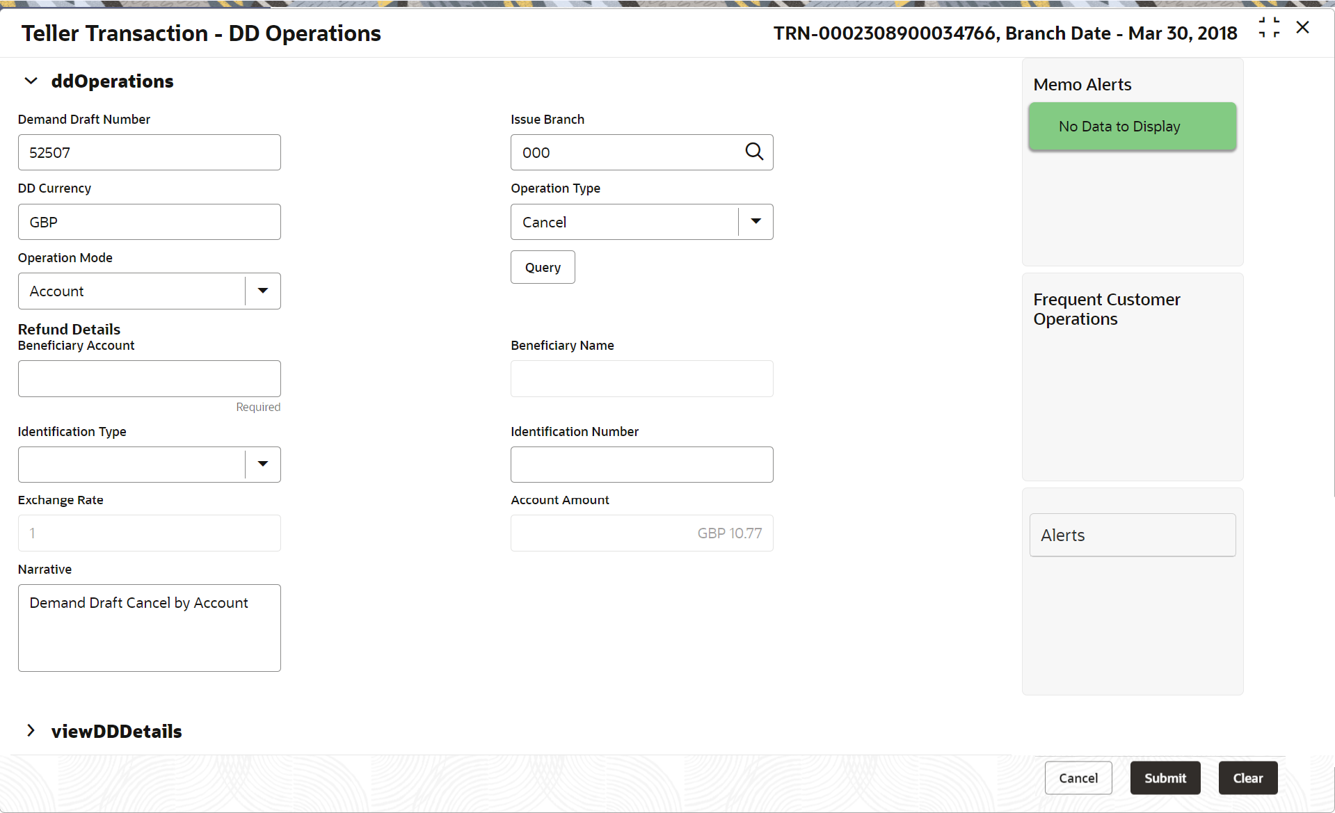

Figure 8-40 DD Operations - Cancel by Account
- On the DD Operations screen, specify the fields. For more information on fields, refer to the field description
table.
The fields marked as Required are mandatory.Table 8-40 DD Operations (Cancel by Account) - Field Description
Field Description Operation Type
Select the type Cancel from the drop-down list.
Demand Draft No
Specify the DD number of the instrument.
Issue Branch
Select the branch code where the instrument is issued from the LOV.
Operation Mode
Select the operation mode as Account from the drop-down values.
Cancel Details
Specify the details under this segment.
Beneficiary Account
Displays the beneficiary account number.
Beneficiary Name
Displays the beneficiary's name.
Identification Type
Select the identification type of the beneficiary from the drop-down values.
Identification Number
Specify the identification number of the beneficiary.
Exchange Rate
Displays the exchange rate, and it can be modified.Note:
If the transaction currency is the same as the account currency, the system will display the exchange rate as 1. This field is displayed only ifMulti-Currency Configuration
at Function Code Indicator level is set as Y.Account Amount
Displays the account amount.Note:
at Function Code Indicator level is set as Y.Total Charge Amount
Displays the total charge amount.Note:
This field is displayed only ifTotal Charges Configuration
at Function Code Indicator level is set as Y.Narrative
Displays the default narrative as DD Cancel by Account, and it can be modified.
