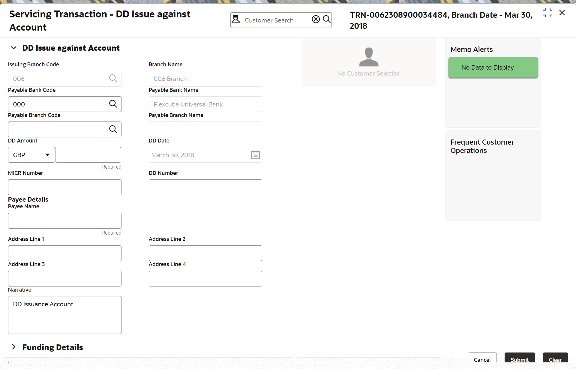

The Teller can use the DD Issue Against Account screen to issue a DD against the CASA of a customer.
- On the Homepage, from Teller mega menu, under
Remittances, click DD Issue -
Account or specify DD Issue - Account in
the search icon bar and select the screen.The DD Issue Against Account screen is displayed.
- On the DD Issue Against Account screen, specify the
fields. For more information on fields, refer to the field description
table.
The fields marked as Required are mandatory.Table 8-23 DD Issue Against Account - Field Description
Field Description Issuing Branch Code
Displays the logged-in branch code.
Branch Name
Displays the branch description of issuing branch.
Payable Bank Code
Select the payable bank code. The list of values contains the bank codes maintained using the External Bank Code Maintenance screen.Note:
To remit funds within the same bank, select the logged-in bank code as payable bank code. To remit funds across banks, select the necessary bank code as payable bank code. The fields Payable Branch Code and Payable Branch Name will be enabled after you specify the Payable Bank Code.Payable Bank Name
Displays the name of the selected bank code.
Payable Branch Code
Select the branch code of the payable bank. The list of values contains the corresponding branch codes maintained using the Bank Code Maintenance screen.
Payable Branch Name
Displays the branch name of the selected branch code.
DD Amount
Specify the DD currency and DD amount.
DD Date
Specify the date that needs to be mentioned in the DD.
MICR No
Displays the MICR number.
DD No
Specify the instrument number and validate. If not specified, the system generates the DD number based on the maintenance setup.
Payee Details
Specify the fields.
Payee Name
Specify the payee name on which the DD is drawn.
Address Line 1 to Address Line 4
Specify the address of the payee.
Narrative
Displays the narrative as DD Issuance Account and it can be modified.

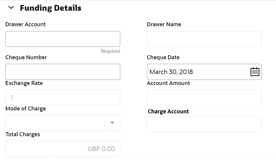

- Click on the Funding Details data segment.The Funding Details data segment is displayed.
- On the Funding Details data segment, specify the fields.
table.
The fields marked as Required are mandatory.Table 8-24 Funding Details - Field Description
Field Description Drawer Account
Specify the account number of the customer who has requested the DD.
Drawer Name
Displays the name of the specified drawer account number.
Cheque Number
Specify the cheque number of the drawer account.
The system validates the status of the cheque and prompts an error message if incase of a Used or Stopped or Invalid cheque.Cheque Date
Specify the date as mentioned in the cheque.
Exchange Rate
Displays the exchange rate.Note:
If the transaction currency is the same as the account currency, the system will display the exchange rate as 1. This field is displayed only ifMulti-Currency Configurationat the Function Code Indicator level is set as Y.Account Amount
Displays the account amount in account currency.Note:
This field is displayed only ifMulti-Currency Configurationat the Function Code Indicator level is set as Y.Mode of Charge
Select the mode of charge from the following drop-down values (Account or Other Account).
Charge Account
This field is populated based on the following criteria:
If Account is selected as Mode of Charge, the drawer account number will be selected as charge account.
If Other Account is selected as Mode of Charge, specify the other account number in this field.
Total Charges
Displays the total charges applicable for the DD issuance.Note:
This field is displayed only ifTotal Charges Configurationat the Function Code Indicator level is set as Y. -
