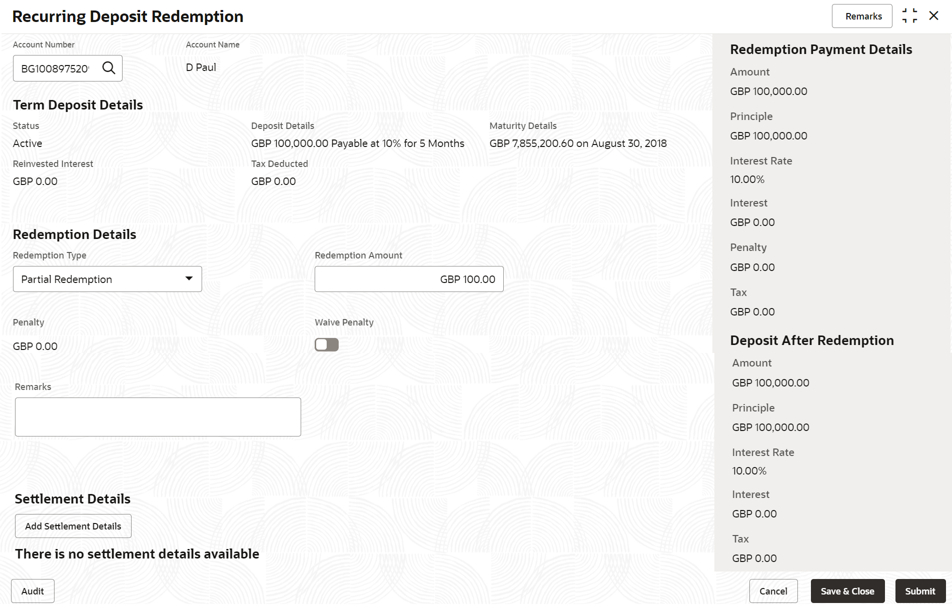

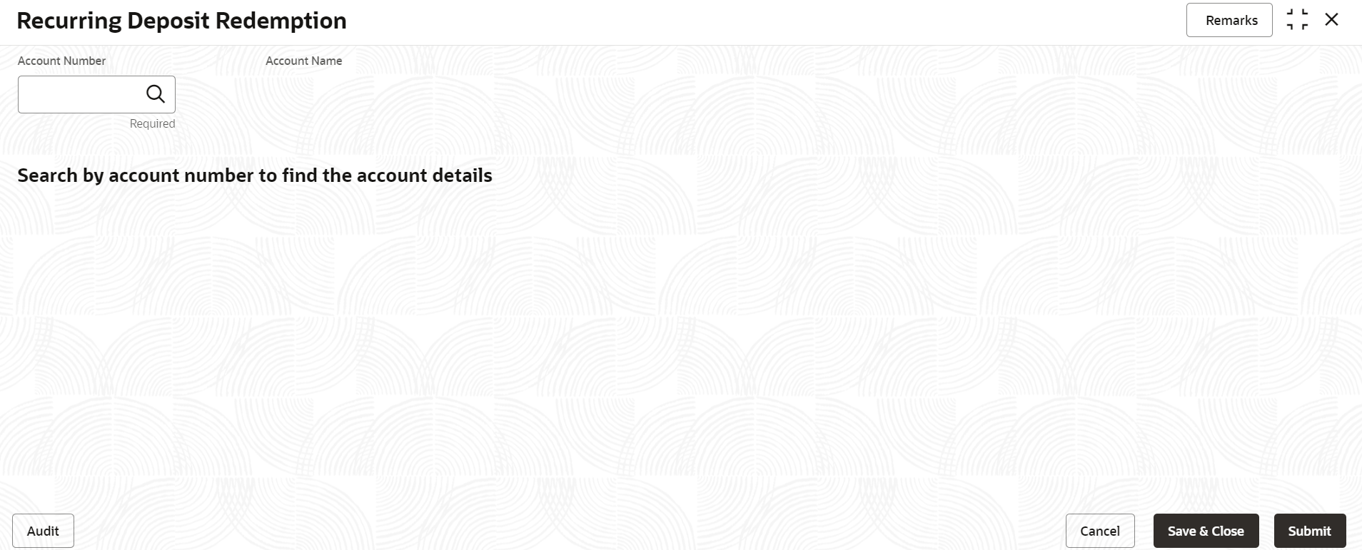

- On the Recurring Deposit Redemption screen, click the
icon or specify the account number in the Account
Number field, and press Enter or
Tab.The details are displayed in the Recurring Deposit Redemption screen.Figure 7-19 Recurring Deposit Redemption Details
- In the Recurring Deposit Redemption screen, perform the
required action. For more information on fields, refer to the field description
table.

Remarks You can specify the reason for RD redemption. - Based on the input data provided, the system simulates the details of RD and
displays them on the right side of the Recurring Deposit
Redemption screen.For more information on fields, refer to the field description table.

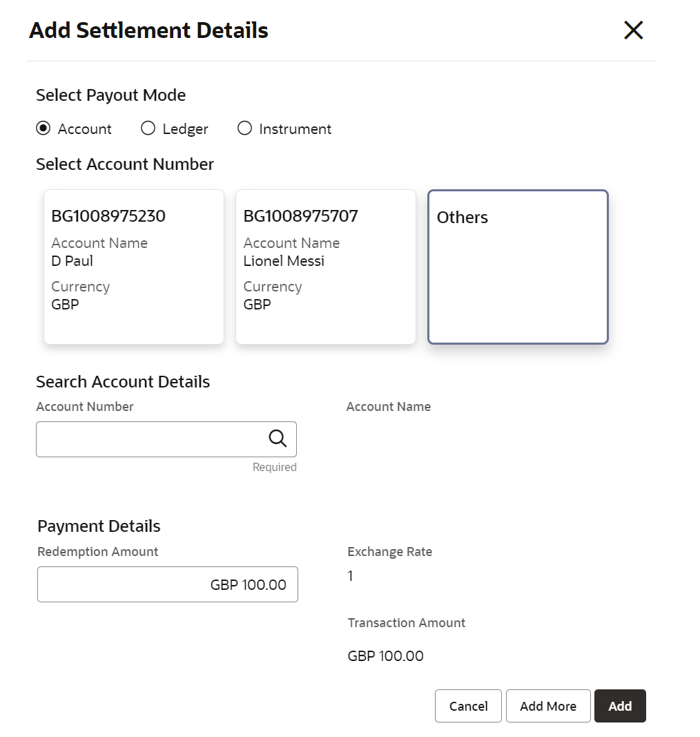

Once the deposit simulation is completed, you can provide the simulated details to the customer. - On Recurring Deposit Redemption screen, click
Add Settlement Details button.The Add Settlement Details screen is displayed with the default payout mode as Account.

For more information on fields, refer to the field description table.Table 7-15 Add Settlement Details - Account
Field Description Select Payout Mode The Account mode is selected with the default. Select Account Number The own accounts are displayed as widgets with the Account Number, Account Name, and Currency. You can select the account for RD payout. You can select Others from the widget to select any other accounts in the same bank for RD payout.
Search Account Details If you select Others from the widgets, the Account Number field is diplayed to specify the account number. click the
Account Number field and
the Account Name is displayed
adjacent to the account number.
Redemption Amount Displays the amount and you can modify the amount in case the amount is payout by different modes or accounts. Exchange Rate Displays the exchange rate. Note:
This field is displayed only if there is cross currency transaction.Transaction Amount Displays the amount in payout account currency. Note:

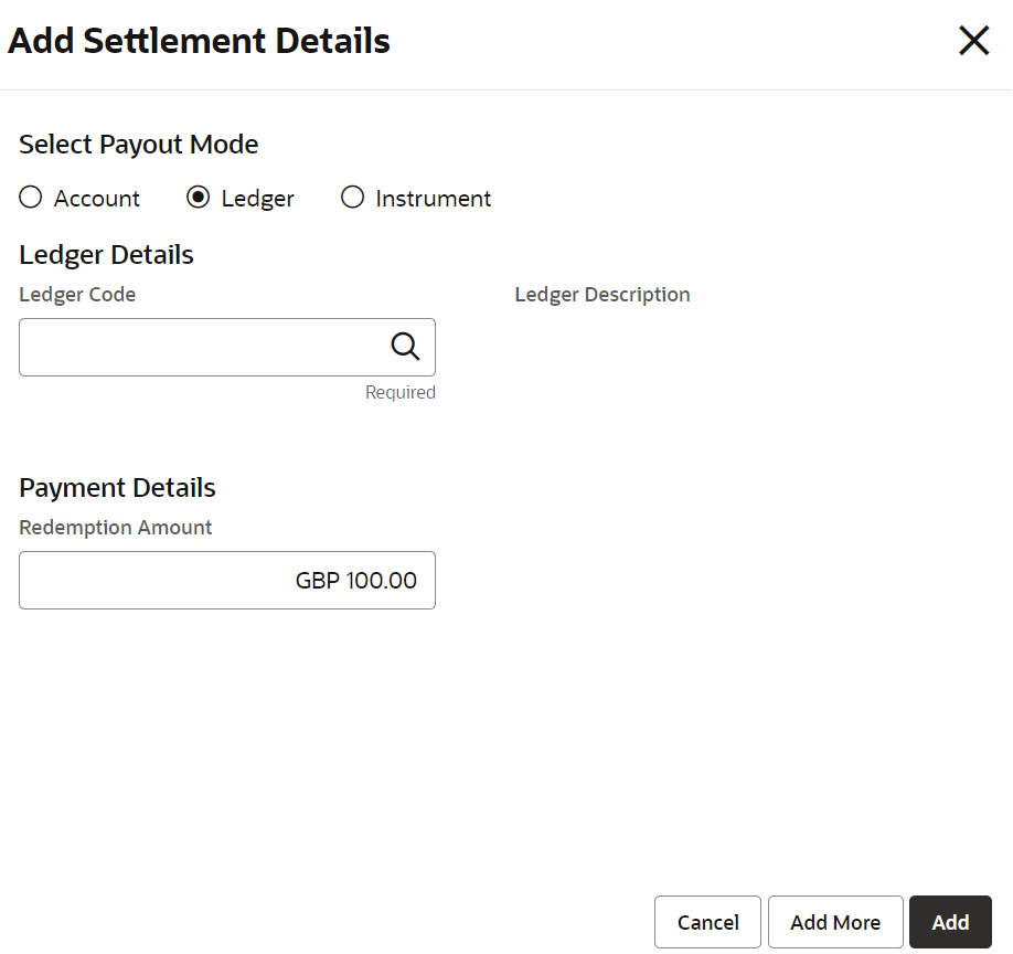

This field is displayed only if there is cross currency transaction. - On Add Settlement Details screen, select
Ledger as the payment mode.The ledger details are displayed in the Add Settlement Details screen.
Figure 7-21 Recurring Deposit Redemption - Ledger
For more information on fields, refer to the field description table.Table 7-16 Add Settlement Details - Ledger
Field Description Ledger Code Specify the ledger code or click the
icon and specify the ledger code in the
Ledger Code field.

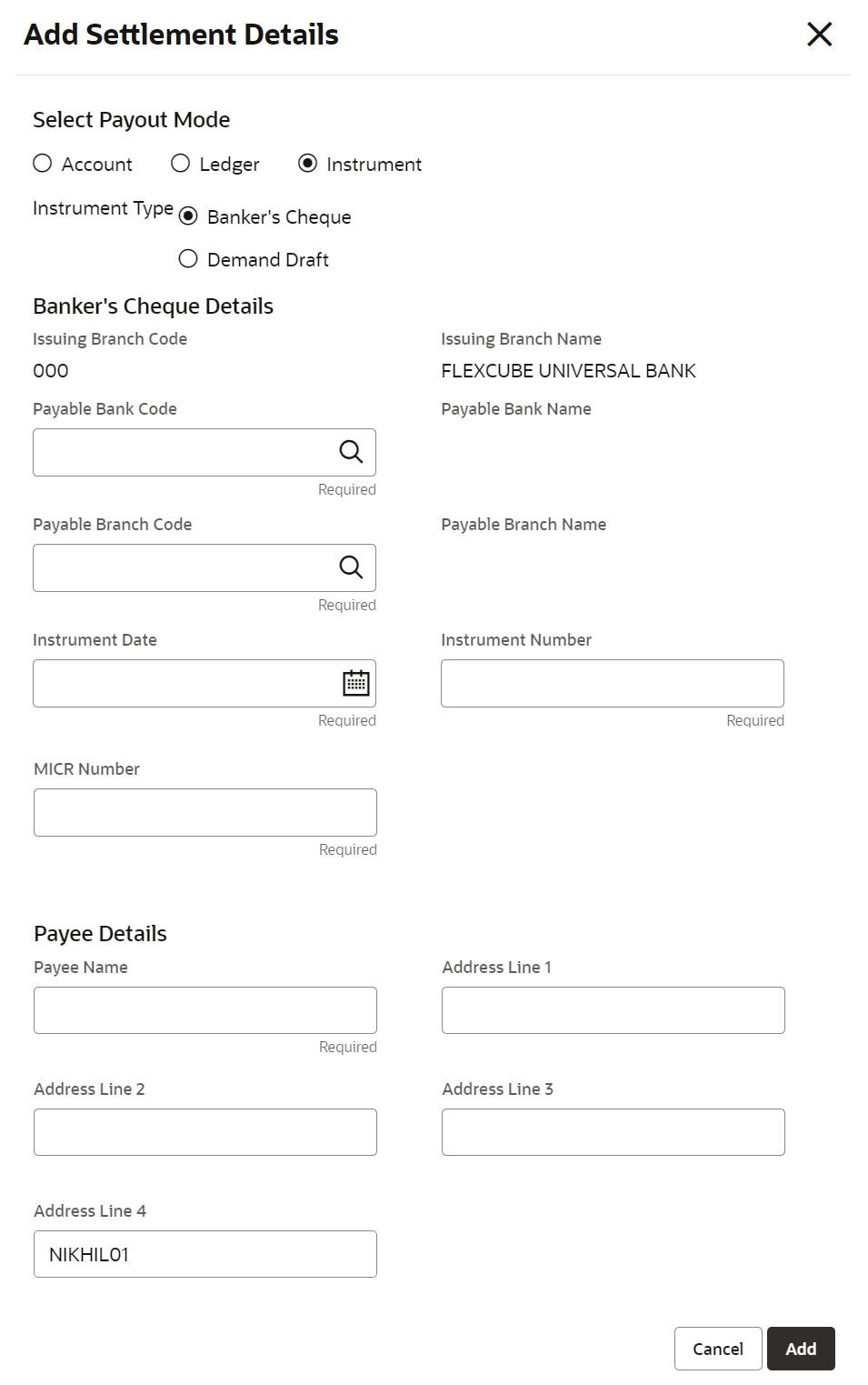

Ledger Description Displays the description once the ledger code is specified. Redemption Amount Displays the amount and you can modify the amount in case the amount is payout by different modes or accounts. - On Add Settlement Details screen, select
Instrument as the payment mode.The instrument details are displayed in the Add Settlement Details screen.
Figure 7-22 Recurring Deposit Redemption - Instrument
For more information on fields, refer to the field description table.Table 7-17 Add Settlement Details - Instrument
Field Description Instrument Type Select the type of instrument for payout. The options are: - Banker's Cheque
- Demand Draft
Issuing Branch Code Displays the branch code issuing the instrument. Issuing Branch Name Displays the branch name issuing the instrument. Payable Bank Code Specify the bank code at which the RD is payable. Payable Bank Name Displays the payable bank name once the payable bank code is specified. Payable Branch Code Specify the branch at which the BC or DD is payable. Payable Branch Name Displays the payable branch name once the payable branch code is specified. Instrument Date Specify the instrument date. Instrument Number Specify the instrument number. MICR Number Specify the MICR number. Payee Name Specify the payee name for the payout. Payee Address Specify the payee address for the payout. - Click Cancel button, to close the Add Settlement Details screen without adding the settlement details.

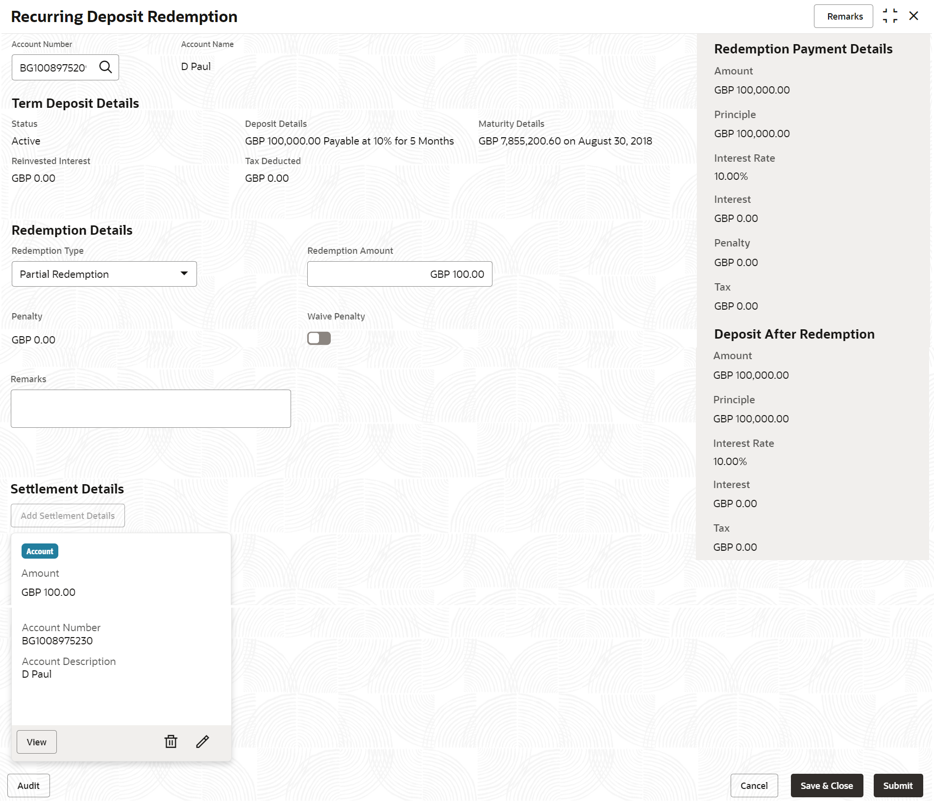

- Click Add More button, the system add the settlement details in the main screen and refresh the Add settlement details screen with default values, and the payout amount updated for remaining settlement amount.
- Click Add button to add the settlement details in
Recurring Deposit Redemption screen.The settlement details are displayed in the Recurring Deposit Redemption screen.
Figure 7-23 Recurring Deposit Redemption - Settltment Details
For more information on fields, refer to the field description table.Table 7-18 Recurring Deposit Redemption - Settlement Details
Field Description Settlement Details For the Account, the system displays the below details.- Currency and Amount
- Account Number
- Account Description
For the Ledger, the system displays the below details.- Currency and Amount
- Ledger Code
- Ledger Description
Exchange rate is displayed only if there is a cross currency transaction.Click the View button to view the settlement details.
Click the
icon to edit the redemption amount in the
settlement details.
Click the
icon to delete the settlement details.
