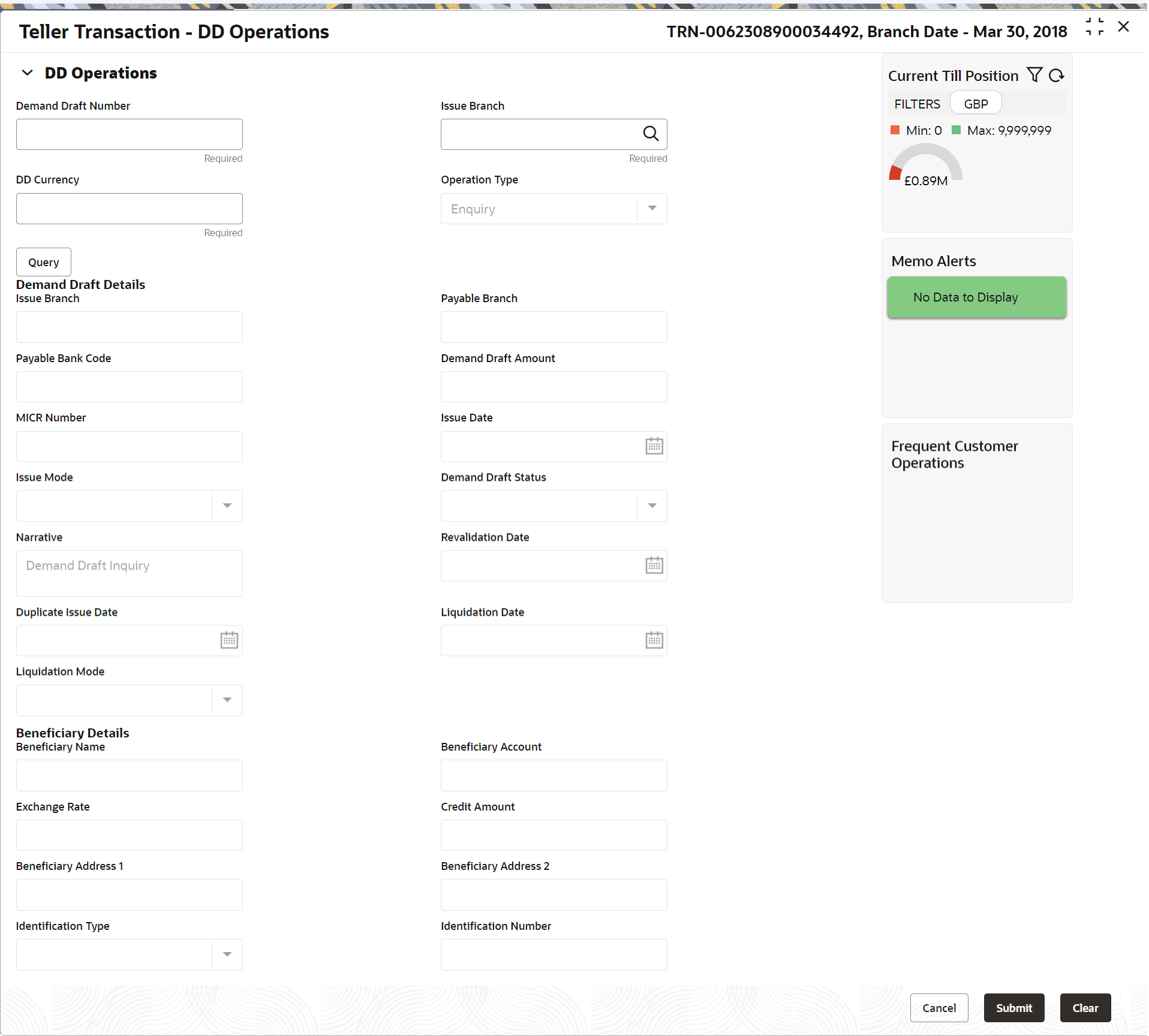

The Teller can use the DD Operations screen to inquire about the details of DD.
- On the Homepage, from Teller mega menu, under
Remittances, click DD
Operations or specify DD Operations in
the search icon bar and select the screen.The DD Operations screen is displayed.
- On the DD Operations screen, specify the fields. For more information on fields, refer to the field description
table.
Table 8-29 DD Operations (Inquiry) - Field Description
Field Description Demand Draft No
Specify the DD number of the instrument.
Issue Branch
Select the branch code where the instrument is issued from the LOV. After you specify the Issue Branch Code and Demand Draft No, press the Tab key. The system will make a service call to Oracle Banking Payments and fetch the demand draft details.
DD Currency
Specify DD Currency to query instrument details.
Operation Type
Select the type Inquiry from the drop-down list.
Query
Click this button to fetch instrument details.
Demand Draft Details
Displays the details of DD under this segment.
Issue Branch
Displays the logged-in branch code.
Payable Branch
Displays the payable branch for the DD.
Payable Bank Code
Displays the payable bank code.
Demand Draft Amount
Displays the DD currency and the DD amount.
MICR No
Displays the MICR number.
Issue Date
Displays the issue date mentioned in the DD.
Issue Mode
Displays the issue mode of the DD.
Demand Draft Status
Displays the status of the DD.
Narrative
Displays the default narrative as Demand Draft Inquiry, and it can be modified.
Revalidation Date
Displays the date of DD revalidation.
Duplicate Issue Date
Displays the duplicate issue date of DD.
Liquidation Date
Displays the liquidation date of DD.
Liquidation Mode
Displays the liquidation mode of DD.
Beneficiary Details
Displays the details.
Beneficiary Name
Displays the beneficiary's name.
Beneficiary Account
Displays the beneficiary account number.
Exchange Rate
Displays the exchange rate, and it can be modified.Note:
If the transaction currency is the same as the account currency, the system will display the exchange rate as 1.Credit Amount
Displays the credit amount.
Beneficiary Address 1 and Beneficiary Address 2
Displays the address of the beneficiary.
Identification Type
Displays the identification type of the beneficiary.
Identification Number
Displays the identification number of the beneficiary.
