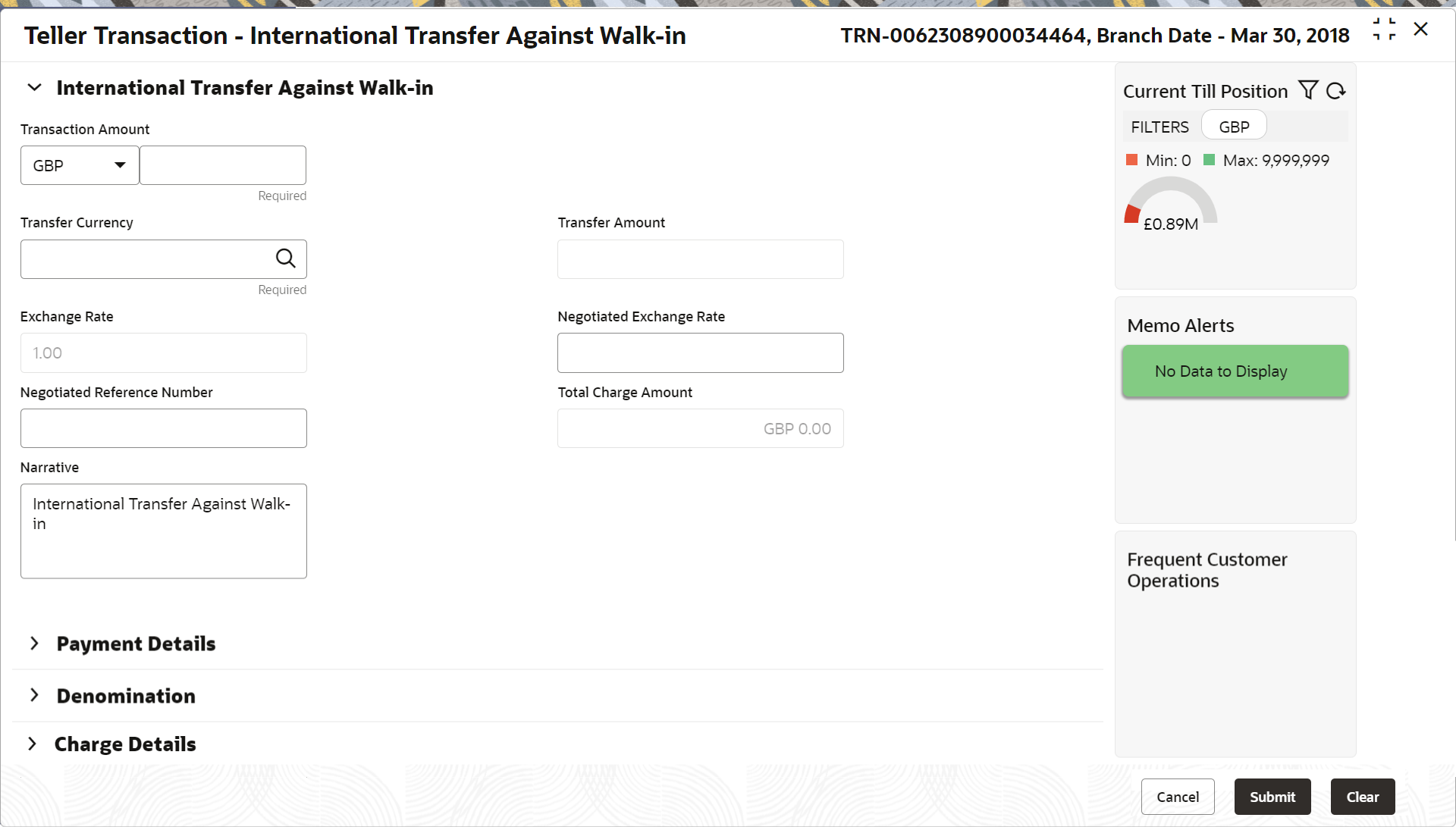

Figure 6-8 International Transfer Against Walk-in
- On the International Transfer Against Walk-in screen,
specify the fields. For more information on fields, refer to the field description
table.
Table 6-8 International Transfer Against Walk-in - Field Description
Field Description Transaction Amount
Specify the currency in which the cash is accepted from the walk-in customer and the transaction amount as requested by the customer.
Transfer Currency
Specify the currency in which the funds are to be transferred.
Transfer Amount
Displays the transfer amount based on the exchange rate pickup.Note:
This field is displayed only ifMulti-Currency Configuration
at Function Code Indicator level is set as Y.Exchange Rate
Displays the exchange rate used to convert the transfer currency into transaction currency, and it can be modified.
If the transfer currency is the same as the account currency, the system displays the exchange rate as 1. This field is displayed only ifMulti-Currency Configuration
at the Function Code Indicator level is set as Y.Negotiated Exchange Rate
Specify the negotiated exchange rate that should be used for foreign currency transactions between the treasury and the branch. You need to specify the negotiated exchange rate only when the currencies involved in the transaction are different.Note:
This field is applicable only if the transaction involves cross currency and only if cross currency enabled andNegotiated_Rate_Enabled Configuration
at Function Code Indicator level is set as Y.Negotiated Reference Number
Specify the unique reference number that should be used for negotiation of cost rate, in foreign currency transaction. If you have specified the negotiated cost rate, then you need to specify the negotiated reference number also.Note:
Accounting system books the online revaluation entries based on the difference in exchange rate between the negotiated exchange rate and transaction rate.Total Charge Amount
Displays the total charge amount, which is computed by the system.Note:
This field is displayed only ifTotal Charges Configuration
at the Function Code Indicator level is set as Y.Narrative
Displays the default narrative as International Transfer Against Walk-in, and it can be modified.
- Specify the payment details. For information on the fields in the Payment Details segment, refer to Add Payment Details for International Transfer.
- Specify the denomination details. For information on the fields in the Denomination Details segment, refer to Add Denomination Details.
- Specify the charge details. For information on the fields in the Charge Details segment, refer to Charge Details.
- Click Submit.
A teller sequence number is generated, and the Transaction Completed Successfully information message is displayed.
The transaction is moved to authorization in case of any warning raised when the transaction saves.When you submit, the transaction details are handed off to the Oracle Banking Payments system for outgoing payment creation and processing with external system status as Pending. After the transaction is processed and responded from Oracle Banking Payments with appropriate status, the Teller selects the transaction from Journal Log and completes the transaction.
