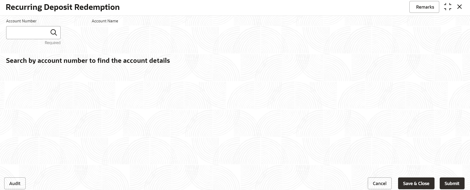

- On the Recurring Deposit Redemption screen, click the
icon or specify the account number in the Account
Number field, and press Enter or

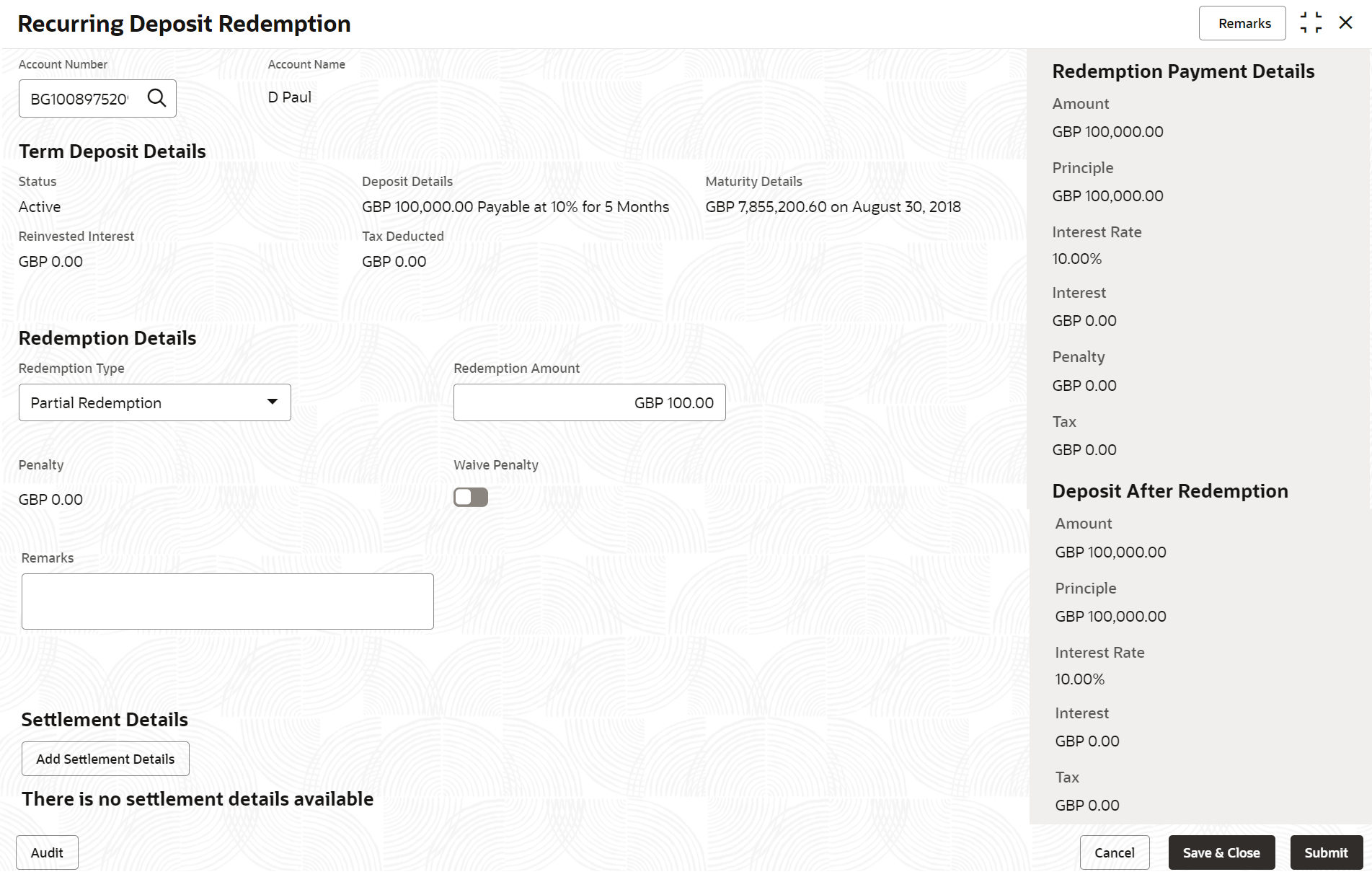

Tab.The details are displayed in the Recurring Deposit Redemption screen.Figure 7-19 Recurring Deposit Redemption Details
- In the Recurring Deposit Redemption screen, perform the
required action. For more information on fields, refer to the field description
table.
Table 7-13 Recurring Deposit Redemption – Field Description
Field Description Account Number Click the
icon and select the account number or specify
the account number to perform RD redemption.
The account holder name is displayed adjacent to this field.Status Displays the RD status. The possible options are: - Active
- Matured
- Closed
Deposit Details Displays the principal balance of the RD, the rate of interest, and the tenor of the RD. Maturity Details Displays the proceeds due to the customer on maturity and the maturity date. Reinvested Interest Displays the amount and currency for the reinvested or paid out interest. Note:
- If the interest if of reinvest type, then the field name is displayed as Reinvested Interest.
- If the interest if of paid out type, then the field name is displayed as Paid out Interest.
Tax Deducted Displays the actual tax deducted on reinvested or paid out interest till date. Redemption Type Select the type of redemption to be performed. The options are: - Partial Redemption
- Full Redemption
The default value is Full Redemption.
You can change the type to Partial Redemption and enter the amount in Redemption Amount field. The redemption amount should be not be greater than RD account balance.Redemption Amount Displays the current principal amount of the RD. Note:
This field is enabled, if you select the Partial Redemption option from the Redemption Type field.Penalty Displays the penalty that will be charged for premature redemption. Waive Penalty Switch to
to waive the penalty amount charged on the
account.
Switch to
to include the penalty amount charged on the
account.
Remarks You can specify the reason for RD redemption. - Based on the input data provided, the system simulates the details of RD and
displays them on the right side of the Recurring Deposit
Redemption screen.For more information on fields, refer to the field description table.
Table 7-14 Redemption Payment Details and Deposit After Redemption – Field Description
Field Description Redemption Payment Details This displays the details of the redemption payment to the customer. Amount This displays the final amount that will be paid out to the customer if the RD is redeemed today. Principal Displays the total principal of the RD. Interest Rate Displays the Interest rate applicable for the RD. Interest Displays the Net interest on the principal (Interest – Tax). Penalty Displays the penalty that will be charged for premature redemption and deducted from the proceeds due to the customer. Tax Displays the tax applicable on the recalculated interest and will be deducted from the proceeds due to the customer. Deposit After Redemption This displays the deposit amount in detail after redemption.
Amount Displays the maturity amount of the remaining recurring deposit.
Principal Displays the principal remaining after redemption.
Interest Rate Displays the interest rate applicable for the remaining principal.
Interest Displays the interest due to the customer on maturity.
Tax Displays the tax that will be deducted on maturity.

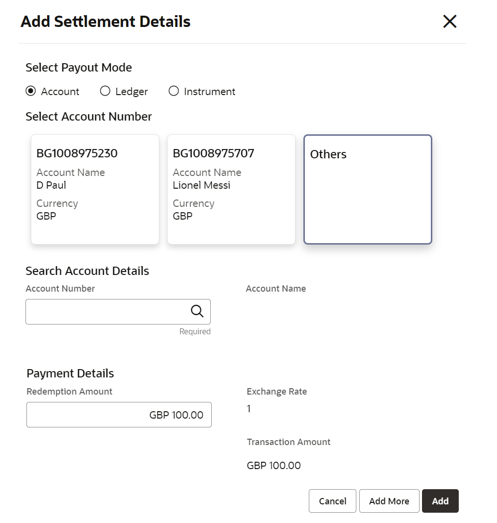

Add Settlement Details button.The Add Settlement Details screen is displayed with the default payout mode as Account.
Figure 7-20 Recurring Deposit Redemption - Account
For more information on fields, refer to the field description table.Table 7-15 Add Settlement Details - Account
Field Description Select Payout Mode The Account mode is selected with the default. Select Account Number The own accounts are displayed as widgets with the Account Number, Account Name, and Currency. You can select the account for RD payout. You can select Others from the widget to select any other accounts in the same bank for RD payout.
Search Account Details If you select Others from the widgets, the Account Number field is diplayed to specify the account number. click the
Account Number field and
the Account Name is displayed
adjacent to the account number.
Redemption Amount Displays the amount and you can modify the amount in case the amount is payout by different modes or accounts. Exchange Rate Displays the exchange rate. Note:
This field is displayed only if there is cross currency transaction.Transaction Amount Displays the amount in payout account currency. Note:

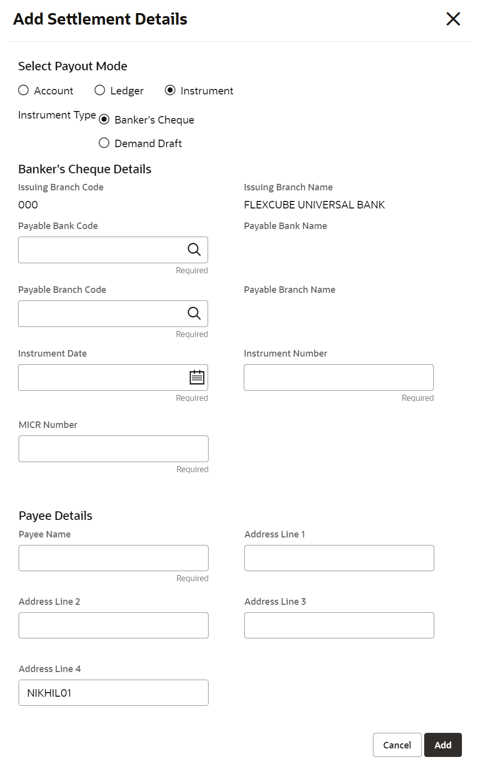

Instrument as the payment mode.The instrument details are displayed in the Add Settlement Details screen.
Figure 7-22 Recurring Deposit Redemption - Instrument
For more information on fields, refer to the field description table.Table 7-17 Add Settlement Details - Instrument
Field Description Instrument Type Select the type of instrument for payout. The options are: - Banker's Cheque
- Demand Draft
Issuing Branch Code Displays the branch code issuing the instrument. Issuing Branch Name Displays the branch name issuing the instrument. Payable Bank Code Specify the bank code at which the RD is payable. Payable Bank Name Displays the payable bank name once the payable bank code is specified. Payable Branch Code Specify the branch at which the BC or DD is payable. Payable Branch Name Displays the payable branch name once the payable branch code is specified. Instrument Date Specify the instrument date. Instrument Number Specify the instrument number. MICR Number Specify the MICR number. Payee Name Specify the payee name for the payout. Payee Address Specify the payee address for the payout. - Click Cancel button, to close the Add Settlement Details screen without adding the settlement details.
