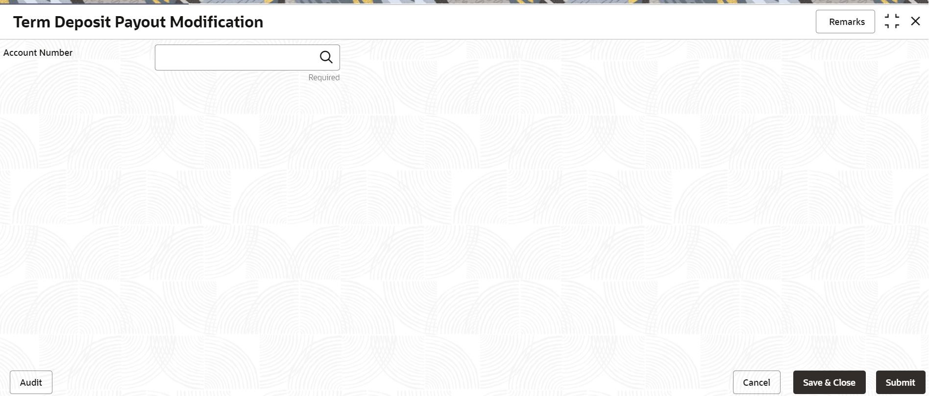

The Term Deposit Payout Modification screen is displayed.
Figure 4-7 Term Deposit Payout Modification

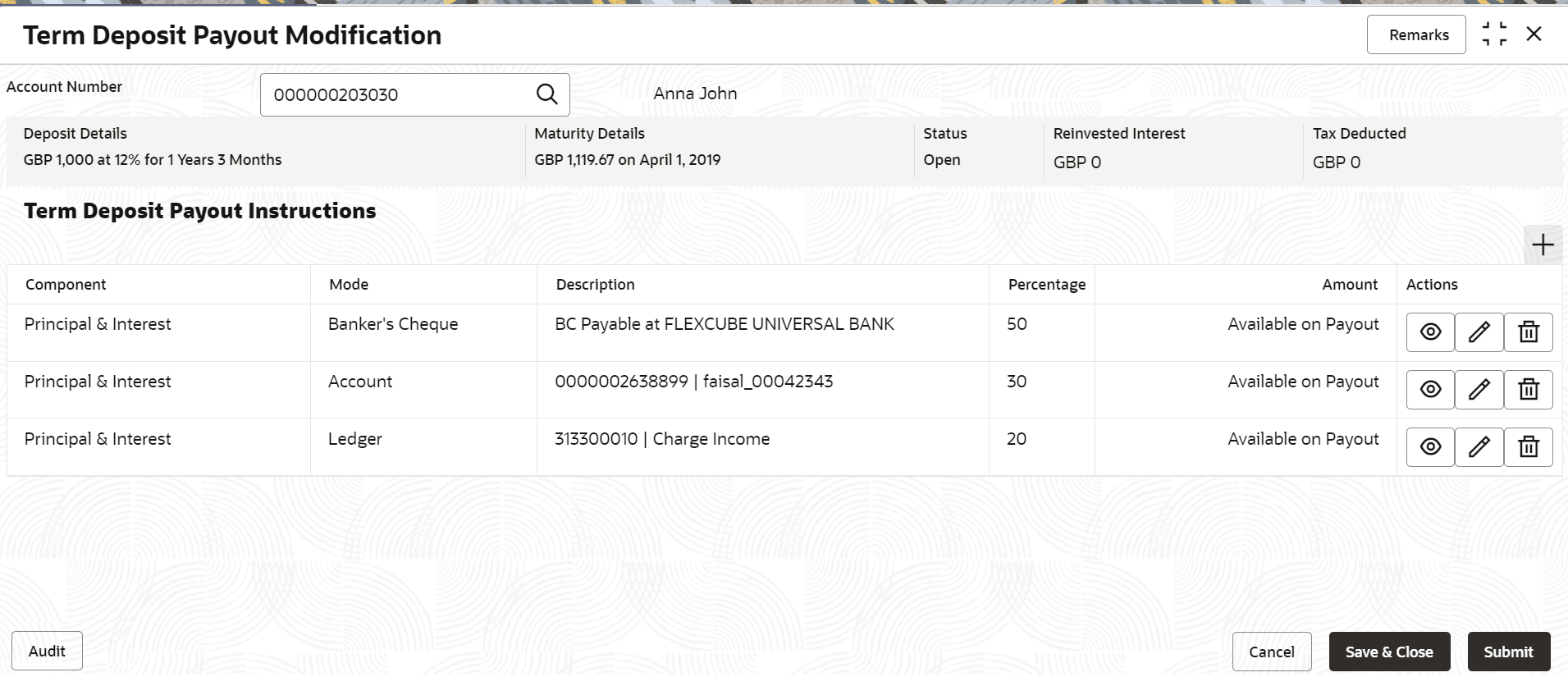

Description of "Figure 4-7 Term Deposit Payout Modification" - On the Term Deposit Payout Modification screen, click
the
icon or specify the account number in the Account
Number field.The details are displayed. - You can view the payout details of the TD account.For more information on fields, refer to the field description
table.

Term Deposit Payout Instructions
This section displays the existing payout instructions of the TD account.
Component
Displays the component of payout. The possible options are:- Principal
- Interest
- Principal & Interest
- Rollover Principal
- Rollover Interest
- Rollover Principal & Interest
Mode
Displays the mode of payout. The possible options are:- Account
- Term Deposit
- Auto Rollover
- Banker's Cheque
- Demand Draft
- Ledger
Description Displays a brief description of the payout.
Based on the payout mode, the description is displayed. The description according to the mode are as follows:- Account – Account Number & Account Name
- Term Deposit – Product Name, Tenor
- Auto Rollover – Tenor
- Banker’s Cheque & Demand Draft – Banker’s Cheque / Demand Draft Payable at <Branch Name>
- Rollover with Additional Funds – Tenor, Additional Amount, Account Number, Amount
- Ledger – Ledger Code, Ledger Name
Percentage Displays the percentage of payout.
Amount Displays the TD payout amount.
For Interest component, this field displays Available on Payout text.Actions Click the
icon, to more details of the payout. For more
information, refer View TD Payout Modification.
Click the
icon, to edit the payout details. For more
information, refer Modify TD Payout
Modification.
Click the
icon, to delete the payout details.
