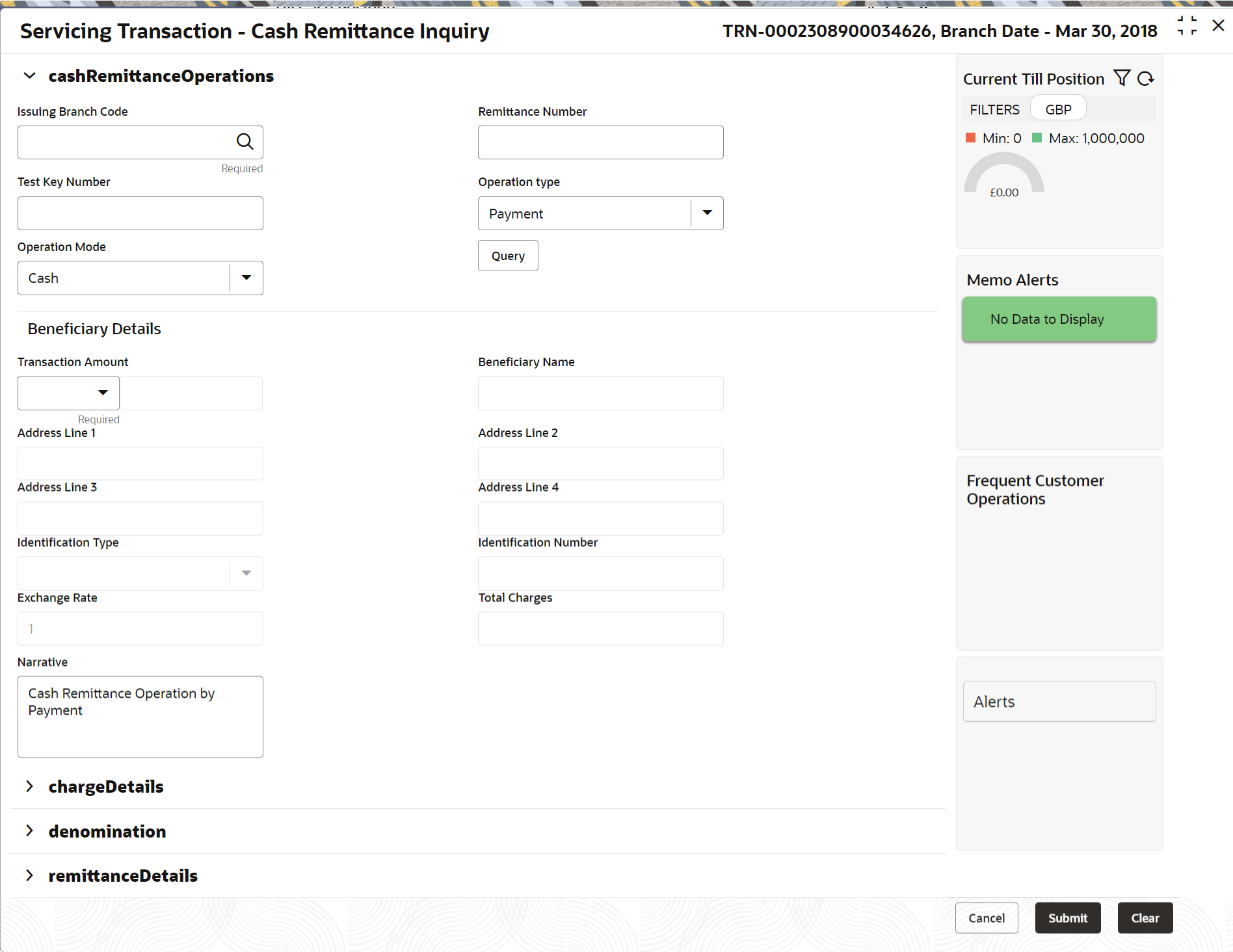

The Teller can use the Cash Remittance Operations screen to make payment against a cash remittance. Reversal of cash remittance payment through EJ/SJ is not supported through Electronic Journal/Service Journal.
The cash remittance payment is made by cash to the beneficiary when the operation mode is Cash.
To make payment against a cash remittance:
- On the Homepage, from Teller mega menu, under
Remittances, click Cash Remittance
Operations or specify Cash Remittance
Operations in the search icon bar and select the screen.The Cash Remittance Operations screen is displayed.
Figure 8-49 Cash Remittance Operations (Payment by Cash)
- On the Cash Remittance Operations screen, specify the
fields. For more information on fields, refer to the field description
table.
The fields marked as Required are mandatory.Table 8-47 Cash Remittance Operations (Payment by Cash) - Field Description
Field Description Issuing Branch Code
Select the branch code where the remittance is issued.
Test Key No
Specify the test key number.
Remittance No
Specify the remittance number.
Operation Type
Select the type Payment from the drop-down list.
Operation Mode
Select the operation mode as Cash from the drop-down values.
Query
Click Query to fetch the remittance details.Note:
When you click this icon, after you specify the Issue Branch Code and Remittance No, the system will make a service call to Oracle Banking Payments and fetch the remittance details.Beneficiary Details
Specify the details under this segment.
Transaction Amount
Displays the transaction currency and a transaction amount.Note:
By default, the local branch currency is displayed as transaction currency and it can be modified.Beneficiary Name
Specify the beneficiary's name.
Address Line 1 to Address Line 4
Specify the address of the beneficiary.
Identification Type
Select the identification type of the beneficiary from the drop-down values.
Identification No
Specify the identification number of the beneficiary.
Exchange Rate
Displays the exchange rate, and it can be modified.Note:
If the transaction currency is the same as the account currency, the system will display the exchange rate as 1. This field is displayed only ifMulti-Currency Configurationat the Function Code Indicator level is set as Y.Total Charges
Displays the total charge amount.Note:
This field is displayed only ifTotal Charges Configurationat the Function Code Indicator level is set as Y.Narrative
Displays the default narrative as Cash Remittance Operation by Payment, and it can be modified.
