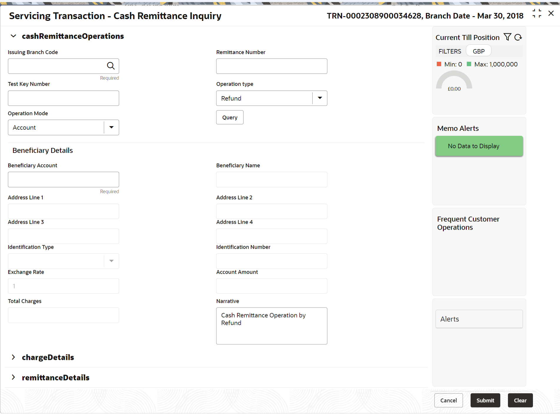

Figure 8-51 Cash Remittance Operations (Refund by Account)
- On the Cash Remittance Operations screen, specify the
fields. For more information on fields, refer to the field description
table.
The fields marked as Required are mandatory.Table 8-49 Cash Remittance Operations (Refund by Account) - Field Description
Field Description Issue Branch Code
Select the branch code where the remittance is issued.
Remittance No
Specify the remittance number.
Test Key No
Specify the test key number.
Operation Type
Select the type Refund from the drop-down list.
Operation Mode
Select the operation mode as Account from the drop-down values.
Query
Click this icon to fetch the remittance details.Note:
When you click this icon, after you specify the Issue Branch Code and Remittance No, the system will make a service call to the Oracle Banking Payments and fetch the remittance details.Beneficiary Details
Specify the details under this segment.
Beneficiary Account
Displays the beneficiary account number.
Beneficiary Name
Displays the beneficiary's name.
Address Line 1 to Address Line 4
Specify the address of the beneficiary.
Identification Type
Select the identification type of the beneficiary from the drop-down values.
Identification Number
Specify the identification number of the beneficiary.
Exchange Rate
Displays the exchange rate, and it can be modified.Note:
If the transaction currency is the same as the account currency, the system will display the exchange rate as 1. This field is displayed only ifMulti-Currency Configurationat Function Code Indicator level is set as Y.Account Amount
Displays the account amount.Note:
This field is displayed only ifMulti-Currency Configurationat Function Code Indicator level is set as Y.Total Charge Amount
Displays the total charge amount.Note:
This field is displayed only ifTotal Charges Configurationat Function Code Indicator level is set as Y.Narrative
Displays the default narrative as Cash Remittance Operation by Refund, and it can be modified. - Specify the charge details. For information on the fields in the Charge Details segment, refer to Charge Details.
