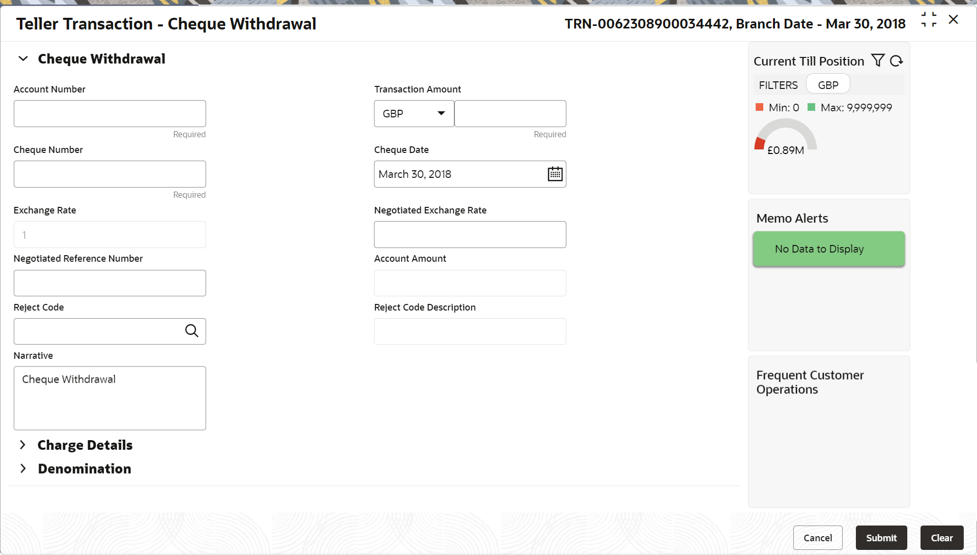

The Cheque Withdrawal screen is used to withdraw cash from the CASA account of the customer against the in-house cheque.
The withdrawal is subject to the availability of a sufficient balance or available
credit limit. To verify the signature for the transactions, you can click
Verify button in the Customer Information
Widget. The signature verification is applicable for the
transactions, which have the Signature Verification Required option
selected as Y at the Function Code Preference level.

- On the Cheque Withdrawal screen, specify the fields. For more information on fields, refer to the field description
table.
The fields marked as Required are mandatory.Table 4-4 Cheque Withdrawal - Field Description
Field Description Account Number
Specify a valid account number for the customer. Note:
When you press the Tab key, the corresponding account information will be displayed in the Customer Information widget.The system displays an override or error message on the tab out of Account Number based on the account dormancy parameters.
Transaction Amount
Displays the local currency of the branch. You can also select another currency from the drop-down list. Specify the transaction amount that needs to be debited from the customer account.
Cheque Number
Specify the cheque number of the customer account as provided by the Customer.
The system validates the status of the cheque and prompts an error message if incase of a Used or Stopped or Invalid cheque.Cheque Date
Select the date on which the cheque has been issued from the calendar option.
Exchange Rate
Displays the exchange rate used to convert the transaction currency into account currency and it can be modified.Note:
If the transaction currency is the same as the account currency, the system displays the exchange rate as 1. This field is displayed only ifMulti-Currency Configurationat Function Code Indicator level is set as Y.Negotiated Exchange Rate
Specify the negotiated exchange rate that should be used for foreign currency transactions between the treasury and the branch. You need to specify the negotiated exchange rate only when the currencies involved in the transaction are different.Note:
This field is applicable only if the transaction involves cross currency and only if cross currency enabled andNegotiated_Rate_Enabled Configurationat Function Code Indicator level is set as Y.Negotiated Reference Number
Specify the unique reference number that should be used for negotiation of cost rate, in foreign currency transaction. If you have specified the negotiated cost rate, then you need to specify the negotiated reference number also.Note:
Accounting system books the online revaluation entries based on the difference in exchange rate between the negotiated exchange rate and transaction rate.Reject Code
Select the reject code from the list of values, which are maintained in the Reject Code Maintenance screen.Note:
If the cheque withdrawal transaction needs to be rejected, you can reject it by specifying the appropriate reject code in this field. The transaction can be rejected for one of the following reasons:-
Insufficient funds
Signature mismatch
Stale cheque
Reject Code Description
Displays the description of the specified reject code.
Account Amount
Displays the transaction amount converted in terms of account amount based on the exchange rate.Note:
This field is displayed only ifMulti-Currency Configurationat Function Code Indicator level is set as Y.Narrative
Displays the default narrative as Cheque Withdrawal, and it can be modified.
