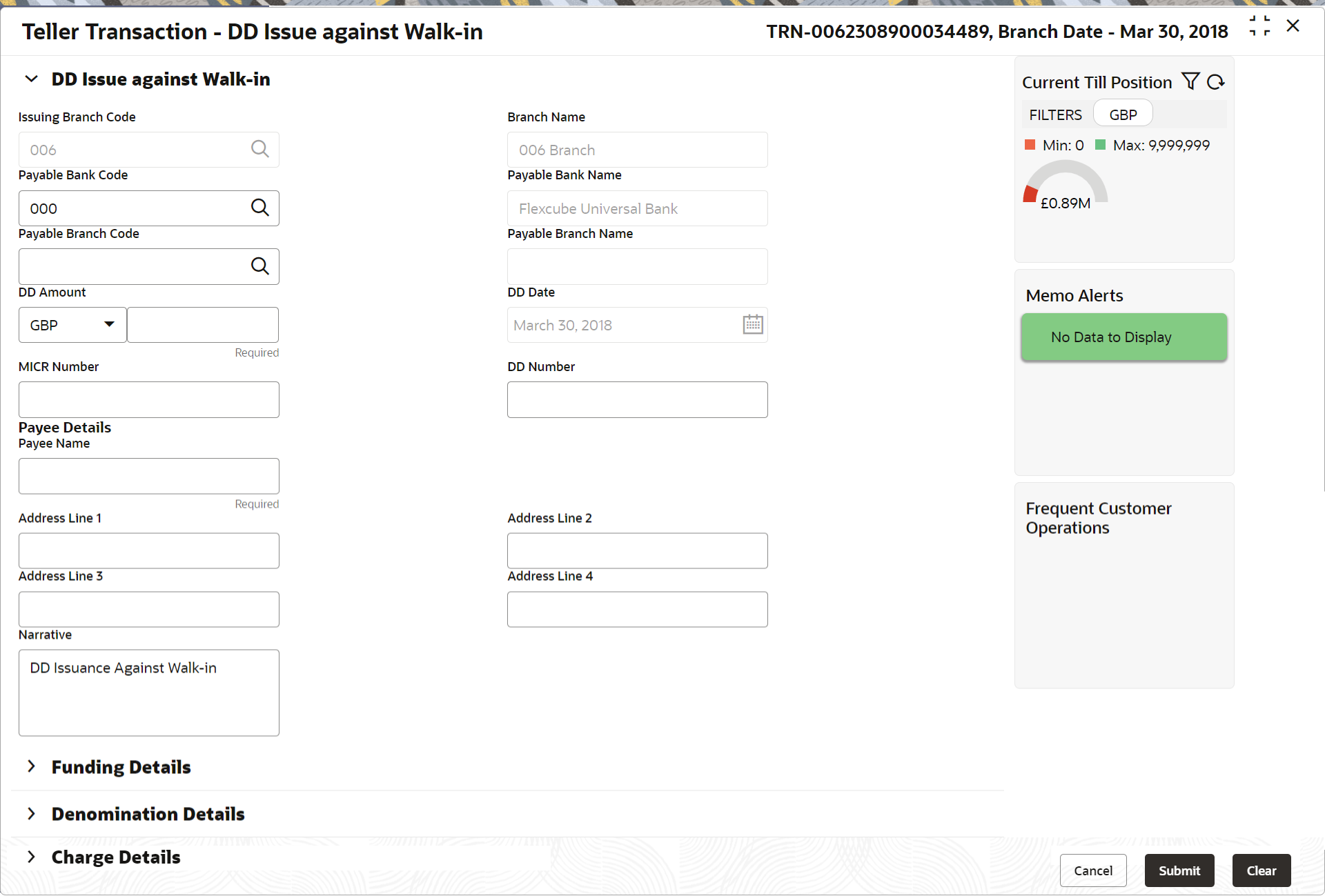

8.2.2 DD Issue Against Walk-in
The Teller can use the DD Issue Against Walk-in screen to issue a DD by cash to the walk-in customers.
To issue a DD to a walk-in customer:
  1. On the Homepage, from Teller mega menu, under Remittances, click DD Issue - Walk-in or specify DD Issue - Walk-in in the search icon bar and select the screen.
    The DD Issue Against Walk-in screen is displayed.
    Figure 8-24 DD Issue Against Walk-in
  2. On the DD Issue Against Walk-in screen, specify the fields. For more information on fields, refer to the field description table.
    The fields marked as Required are mandatory.
    Table 8-24 DD Issue Against Walk-in - Field Description
    Field Description
    Issuing Branch Code
    Displays the logged-in branch code.
    Branch Name
    Displays the branch description of issuing branch.
    Payable Bank Code
    Select the payable bank code. The list of values contains the bank codes maintained using the External Bank Code Maintenance screen.
    To remit funds within the same bank, select the logged-in bank code as payable bank code. To remit funds across banks, select the necessary bank code as payable bank code. The fields Payable Branch Code and Payable Branch Name will be enabled after you specify the Payable Bank Code.
    Payable Bank Name
    Displays the name of the selected bank code.
    Payable Branch Code
    Select the branch code of the payable bank. The list of values contains the corresponding branch codes maintained using the Bank Code Maintenance screen.
    Payable Branch Name
    Displays the branch name of the selected branch code.
    DD Amount
    Specify the DD currency and DD amount.
    DD Date
    Specify the date that needs to be mentioned in the DD.
    MICR No
    Displays the serial number.
    DD No
    Specify the instrument number and validate.
    If not specified, the system generates the DD number based on the maintenance setup.
    Payee Details
    Specify the fields.
    Payee Name
    Specify the payee name on which the DD is drawn.
    Address Line 1 to Address Line 4
    Specify the address of the payee.
    Narrative
    Displays the narrative as DD Issuance against Walk-in, and it can be modified.

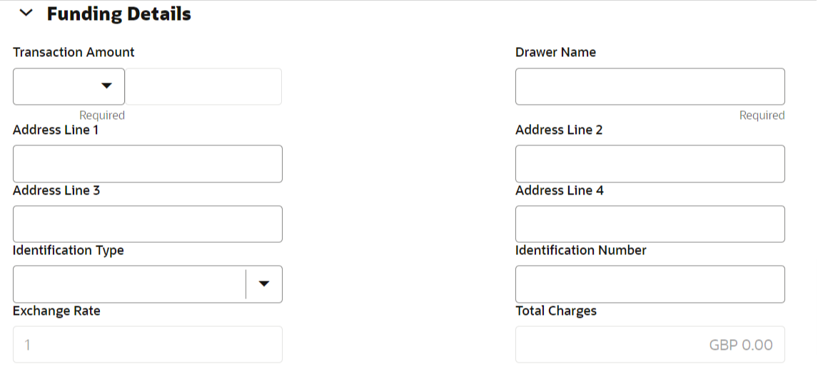

  3. Click on the Funding Details data segment.
    The Funding Details data segment is displayed.
  4. On the Funding Details data segment, specify the fields. For more information on fields, refer to the field description table.
    Table 8-25 Funding Details - Field Description
    Field Description
    Transaction Amount
    Specify the transaction currency, the currency in which the walk-in customer deposit the cash.
    Drawer Name
    Specify the name of the drawer.
    Identification Type
    Select the identification type of the payee from the drop-down list.
    Identification Number
    Specify the identification details of the payee.
    Exchange Rate
    Displays the exchange rate.
    If the transaction currency is the same as the account currency, the system will display the exchange rate as 1. This field is displayed only if Multi-Currency Configuration at the Function Code Indicator level is set as Y.
    Total Charges
    Displays the total charges applicable for the DD issuance.
    This field is displayed only if Total Charges Configuration at Function Code Indicator level is set as Y.
