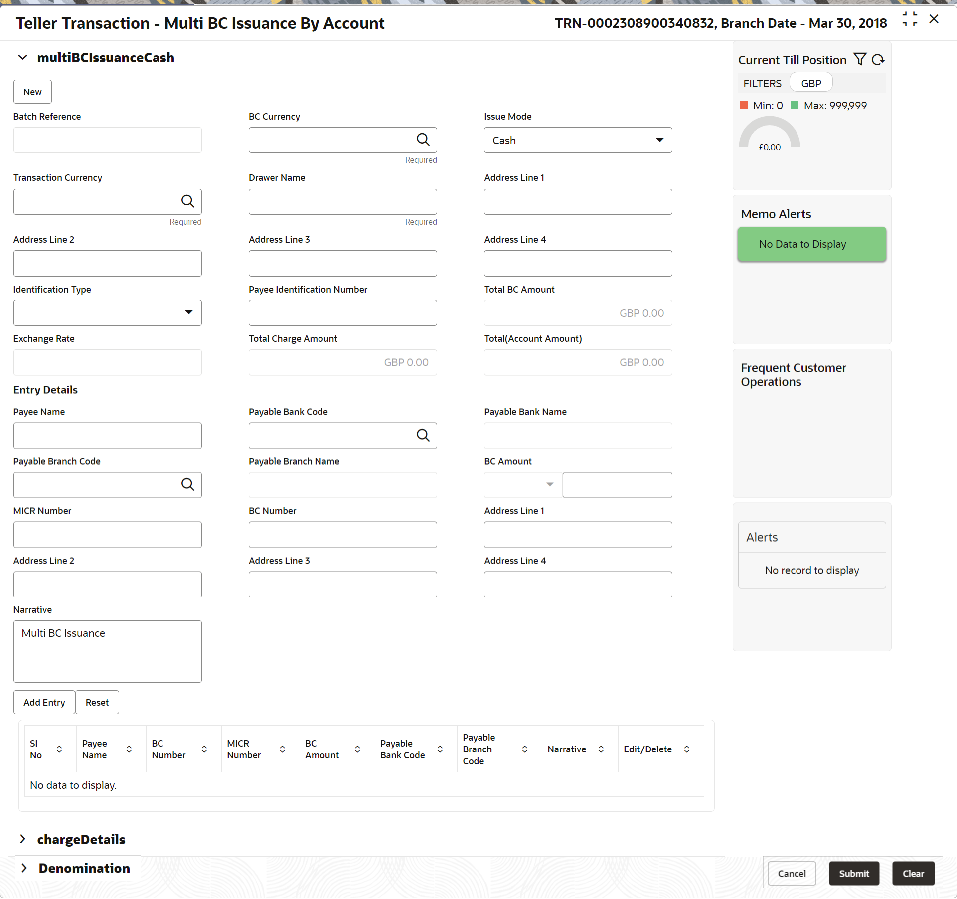

The Teller can use the Multi BC Issuance screen to issue BC against Cash GL for walk-in customers.
- On the Homepage, from Teller mega menu, under
Remittances, click Multi BC
Issuance or specify Multi BC Issuance in
the search icon bar and select the screen.The Multi BC Issuance Cash screen is displayed.
- On the Multi BC Issuance Cash screen, specify the
fields. For more information on fields, refer to the field description
table.
The fields marked as Required are mandatory.Table 8-21 Multi BC Issuance Cash - Field Description

Narrative
Displays the default narrative as Multi BC Issuance, and it can be modified.
Add Entry
After filling the necessary fields, click Add Entry to add a new entry.
Reset
Click Reset to reset the added entries.
- Specify the charge details. For information on the fields in the Charge Details segment, refer to Charge Details.
- Specify the denomination details. For information on the fields in the Denomination segment, refer to Add Denomination Details.
- Click Submit.
A teller sequence number is generated, and the Transaction Completed Successfully information message is displayed.
The transaction is moved to authorization in case of any warning raised when the transaction saves.On transaction submission, the system creates an individual BC transaction and hand-off individual BC issue requests to Oracle Banking Payments system. Once the individual BC transaction is created in Oracle Banking Payments, the system will hand off for the accounting to FLEXCUBE Universal Banking by debiting Customer Account/Cash GL for the individual BC amounts and crediting the intermediary bridge GL. But the charge debit will be a consolidated entry. In case of any rejection from Oracle Banking Payments, the system will not consider the transaction for accounting to FLEXCUBE Universal Banking during console entry.
