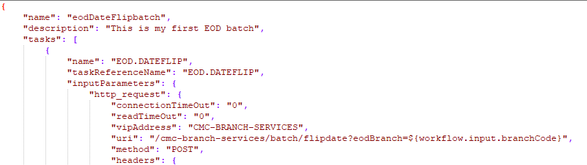

Specify the workflow name (eodDateFlipbatch) as mentioned in the first line ofeodDateFlipbatch.json.Note:
The workflow name should be the same as the value for the name tag in the JSON file. A sample workflow name from a JSON file is shown in the below figure. - Save and authorize the record.
