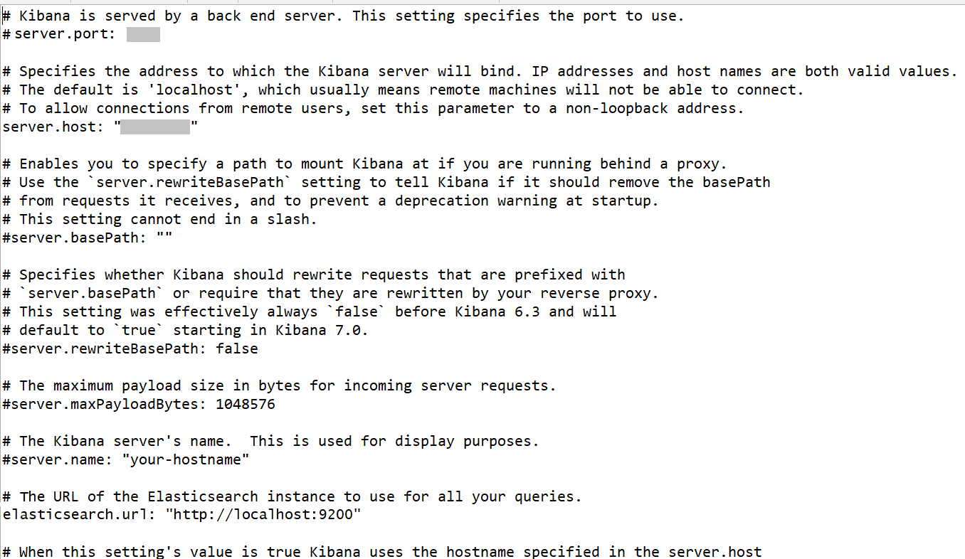

The default ports are as follows:-
Elastic search - 9200
Kibana - 5601

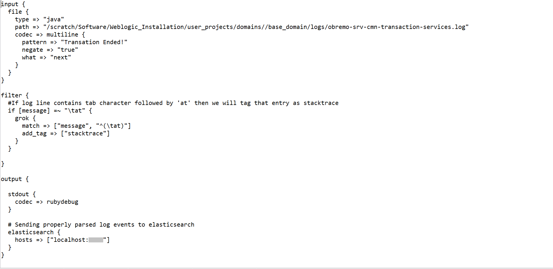

To run the ELK:
