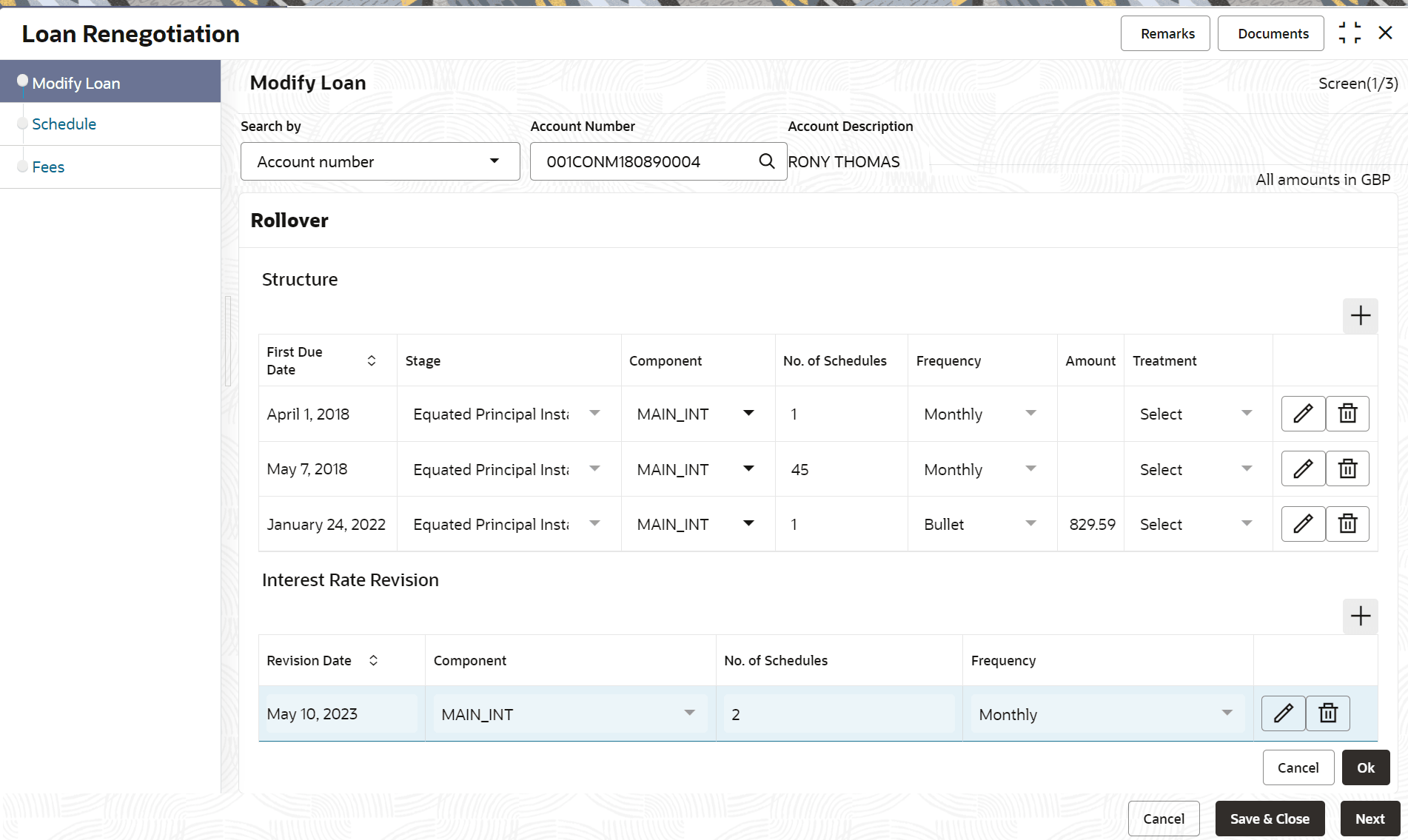

7.2.5 Modifying Rollover Details
You can view the re-draw of schedules considering the rolling over of the loan to new loan schedule starting from current value date until to maturity.
If there is any change in the term, the system will fetch and display the schedule structure until maturity considering the term change. You can also add new or edit existing structure or interest rate revision details.
You will not be allowed to perform the rollover on the loan account, if:- Rollover is not set at the account level.
- You have breached the maximum number of allowed rollovers.
To modify the rollover details:
- Navigate to the screen and fetch the account. For more information, refer Navigating and Fetching Account.
- Click the Rollover link.The Rollover section is displayed.
The Rollover link will not be enabled, if you have performed any action on the Modify Schedule section and committed the changes.Note:
By default, the existing schedule details are displayed in the Structure and Interest Rate Revision section. - From the Structure or Interest Rate
Revision section, click the
icon from the Action field. For more information
on fields, refer to field description table below:Table 7-9 Rollover – Field Description
Field Description Structure This section displays the schedule structure. First Due Date Specify the due date on which the schedule installment is due. Stage Select the applicable loan stage. For amortized loan account, the following are the options: - Equated Principal Installment

Component Select the loan component. Note:
This field is not editable if you select the Equated Principal Installment option from the Stage field.No. of Schedules Specify the number of schedules for the repayment stage. Frequency Select the frequency of installment payment. The options are: - Monthly

Amount Specify the installment amount to be paid. Treatment Select the schedule treatment. The options are: - Capitalize

Interest Rate Revision This section the revision schedule for interest rates. Revision Date Select or specify the date on which the revised interest rate is applied for the account. Component Select the loan component on which revised interest rate is applicable. No. of Schedules Specify the number of schedules for which revised interest rate is applicable. Frequency Select the frequency of rate revision. The options are: - Monthly

- You can add new row by following the steps below:
Interest Rate Revision section, click
the
icon.
- Select or specify the details as required.
- From the Action field, click
the
icon.
The details are added successfully.
the
- Click OK.
