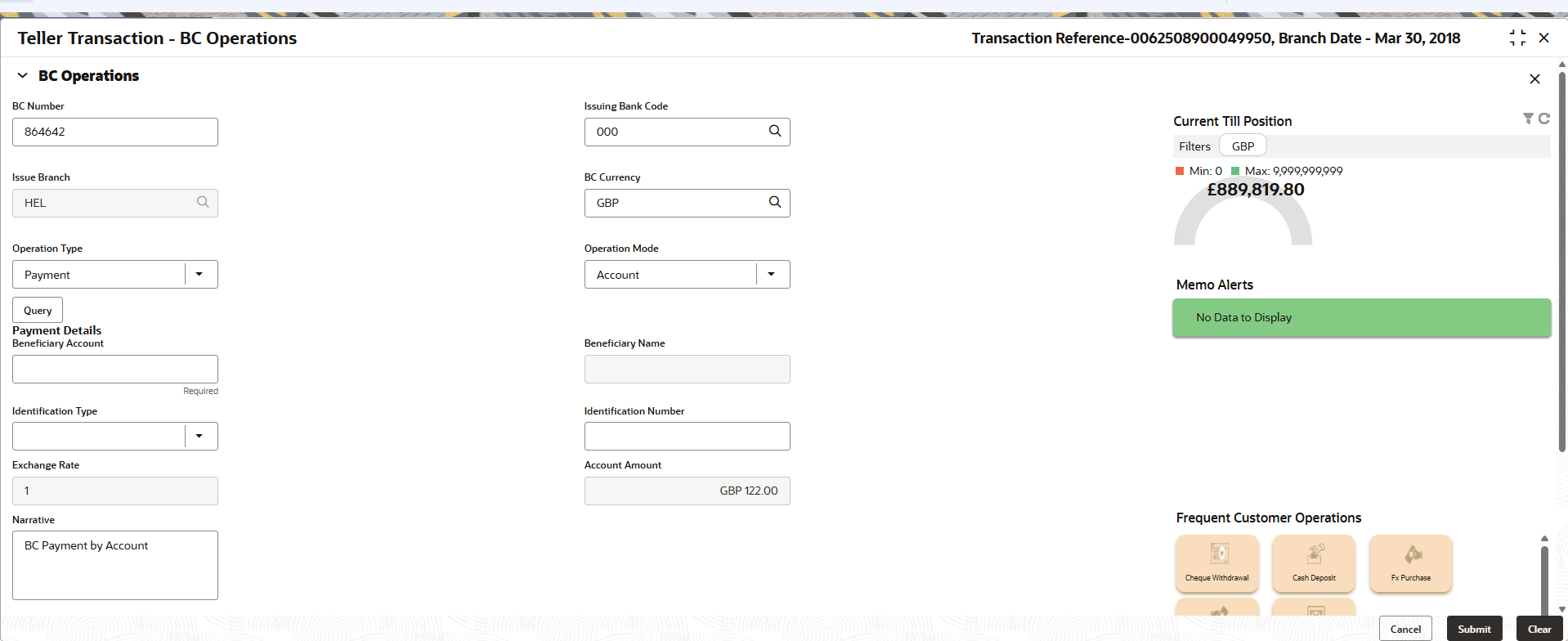

Figure 8-12 BC Operations - Payment by Cash
- On the BC Operations screen, specify the fields. For more information on fields, refer to the field description
table.
The fields marked as Required are mandatory.Table 8-12 BC Operations (Payment by Cash) - Field Description
