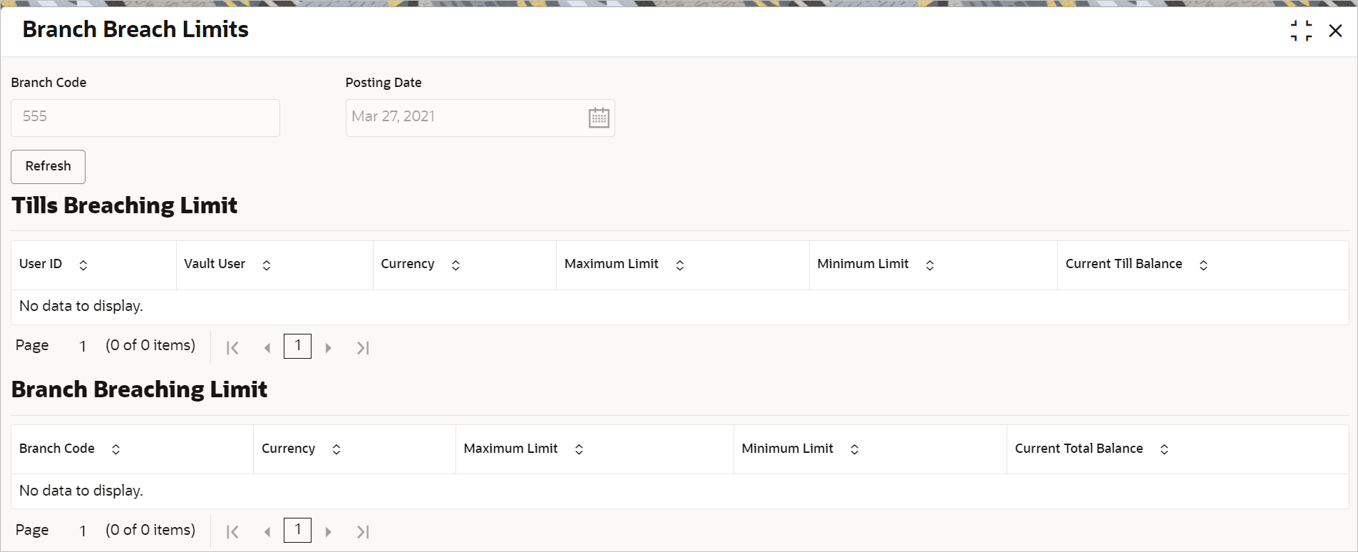

To view the branch breaching limits:
- On the Homepage, from Teller mega menu, under
Branch Operations, click Branch Breach
Limits or specify Branch Breach Limits in
the search icon bar and select the screen.The Branch Breach Limits screen is displayed.
- On the Branch Breach Limits screen, specify the fields.
For more information on fields, refer to the field description
table.
Table 2-6 Branch Breach Limits - Field Description
Field Description Branch Code
Displays the logged-in branch.
Posting Date
Indicates the date on which the branch breaching limits needs to be enquired.Note:
By default, the system displays the current date.Refresh
Click this icon to refresh the details.
Tills Breaching Limit
Specify the fields under this section.
User ID
Displays the list of Tellers/Vault Tellers of the branch.
Vault User
Displays the checkbox if the User ID is a Vault Teller.
Currency
Displays the list of currencies in which the User ID has performed the transactions.
Minimum Limit
Displays the minimum till balance that needs to be maintained for the User ID and currency combination.
Maximum Limit
Displays the maximum till balance that needs to be maintained for the User ID and currency combination.
Current Till Balance
Displays the current till balance based on the till cash position for the specified currency.
Branch Breaching Limit
Displays the values under this section.
Branch Code
Displays the code of the logged-in branch.
Currency
Displays the currency code.
Minimum Limit
Displays the minimum limit that needs to be maintained for the branch.
Maximum Limit
Displays the maximum limit that needs to be maintained for the branch.
Current Total Balance
Displays the branch total cash position, currency-wise.
